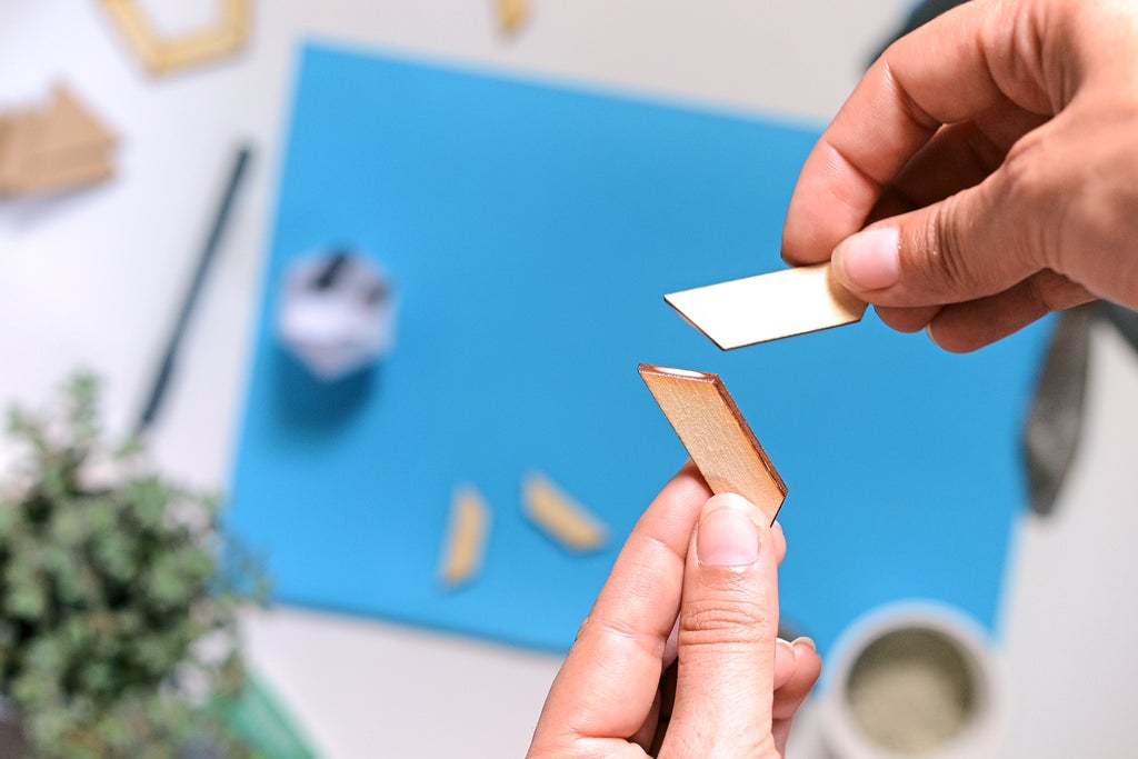

The wooden top is mainly a design element. I really like the wood texture in combination with the concrete surface. I recommend sanding each piece individually before gluing the pieces together. This way the sanding will be much easier.
Use wood glue to assemble the five pieces into a pentagon shape. Wipe off any excess glue with a damp paper towel and then lay on a flat surface and wait for the glue to dry.

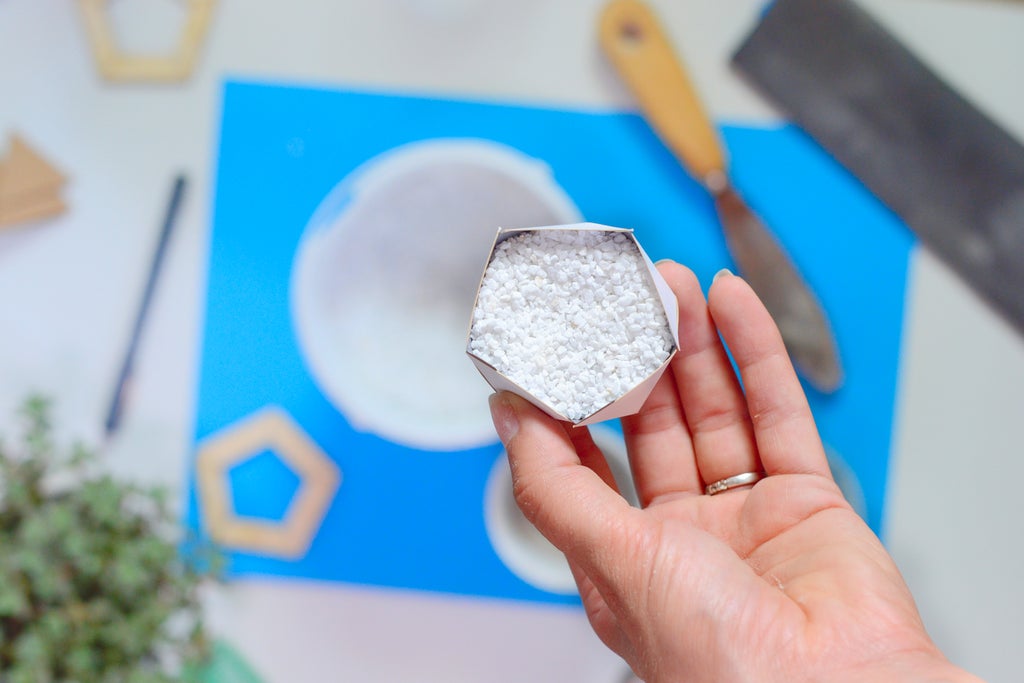

Before you start mixing your concrete, you need to prepare a support for the molds. Because the icosahedron has a pointed tip, it won't stand on its own. I used a jar and a roll of tape as support, but anything with a similar opening will work.
Fill the inner mold with sand or small stones. This is necessary because otherwise, the mold would just float on top of the concrete.

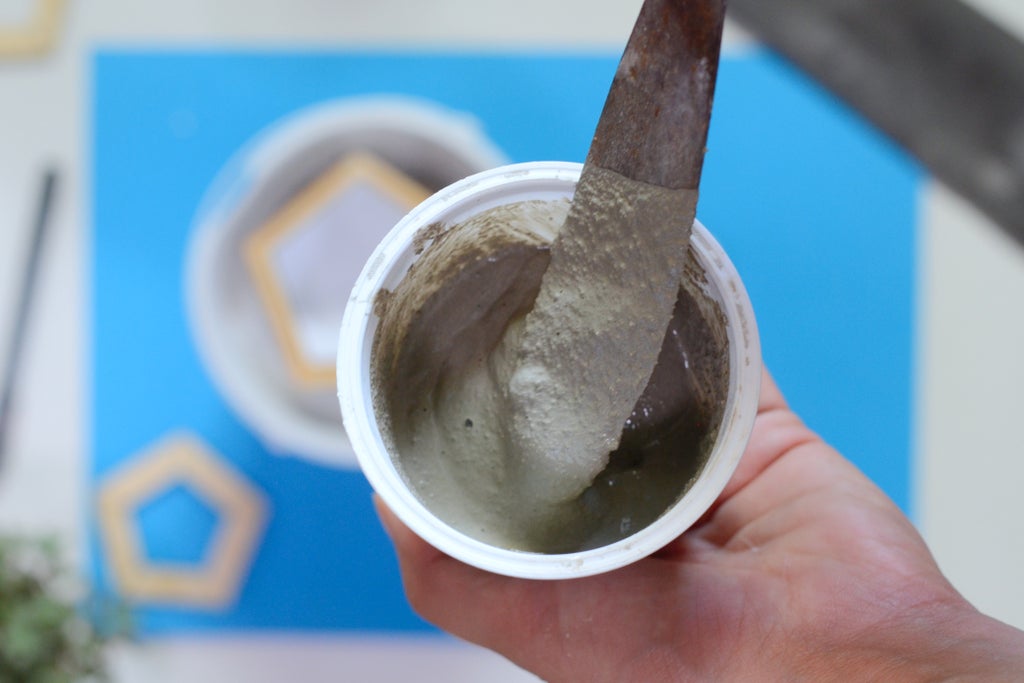

The first step is to add water to the concrete mix. The amount of water you need will depend on the type of concrete you use – check out the descriptions.
Then, use a small putty knife or something similar to mix the concrete thoroughly. I have to confess that did not measure and just added small amounts of water until my concrete mix had a consistency similar to honey. Not using the correct amount of water will reduce the strength of the concrete, but as it is just for the planters and not for a load-bearing element in a building, I can live with that.
