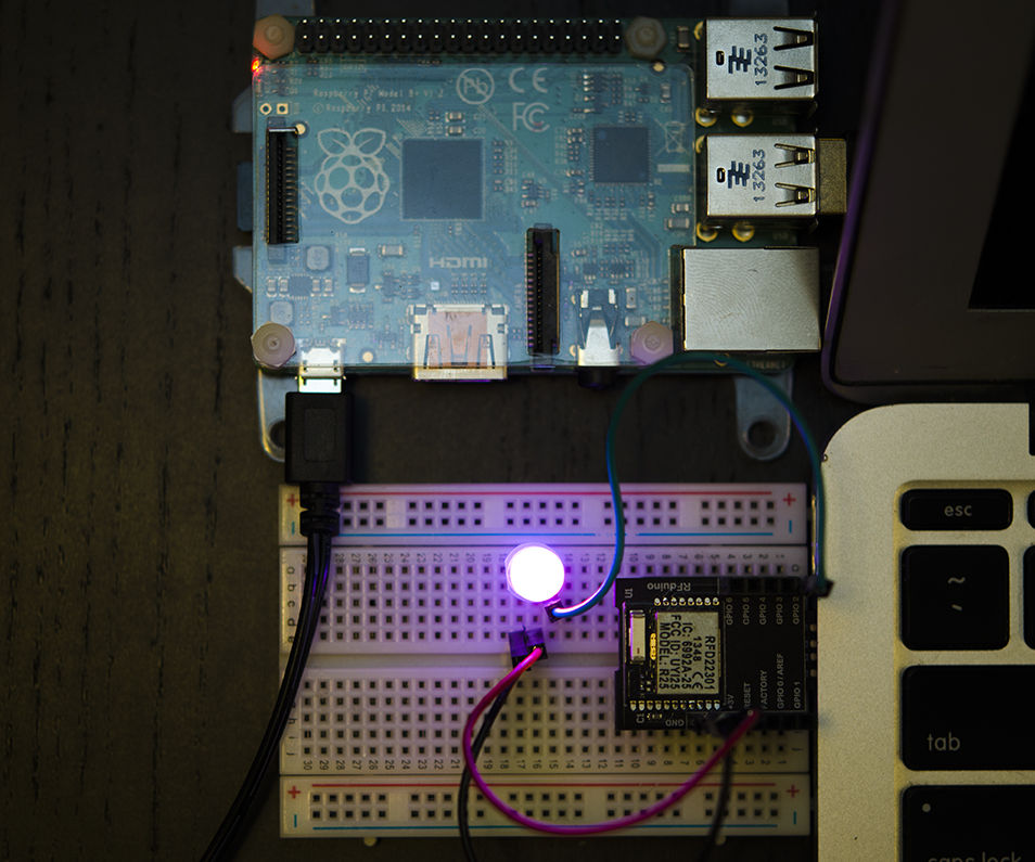

The board includes everything needed including a USB to Serial adapter, surface-mount LED, and voltage regulator. In addition, it is easily mountable on a breadboard for developing your own IoT project(s)!
