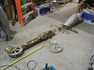

Step 1: Layout
I generally start all my pieces by laying parts out on the floor and arranging them until things start to look right. For this project, large street light covers were going to be the most important forms. These were used for the head, and determined the scale of the whole sculpture. Some rather cheesy brass chandeliers were easy choices for the smaller tentacles. The trick was coming up with the two long tentacles. They needed to look similar to the small ones, but still be flexible and durable. After some fooling around I decided that candle sticks, and fireplace hardware would work if they had aluminum electrical conduit threaded through them. Brass drawer pulls would later be attached to each section to act as suction cups.
It was important to me that the sculpture have a somewhat fluid movement, it is a sea monster after all. I liked the idea of a sort of antiquated machine look, so I came up with a simple belt drive mechanism based on some nice old belt wheels that I found.

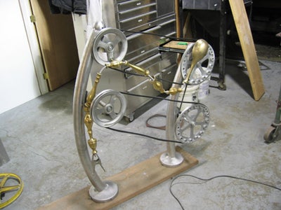

Step 2: Mechanism

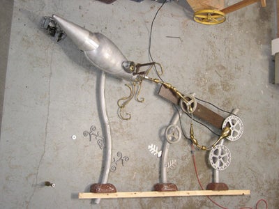

Once I had a decent idea of what the general design was going to be it was time to focus on some specifics. I basically had to work backwards from the mechanical portion of the piece because it required the most precision. The rest could be improvised. From the first stage of laying out the parts, I had determined that the head would be elevated with the tentacles draping down towards their drive system (no sense fighting gravity). This meant mounting the belt wheels in a fixed position to each other that provided the right angle for the head to wind up at the right height.
After a good deal of advil and cursing I had the wheels mounted on bearings welded to stands made from railing sections.

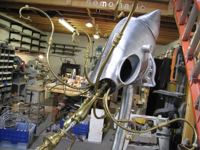

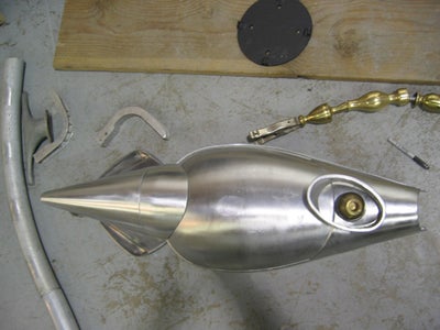

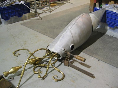

Step 3: Head
Having worked out the basic mechanics, it was time to make some more decisions about the head. All changes here would affect the weight, and potentially mess with the mechanism, so better to settle it early on. Added to the street light fixtures was a small beer keg, a lawn sprinkler base, and a mysterious aluminum cone. The bag attachments from some old vacuum cleaners made nice oval eye sockets with brass candle stick tops for eyes.

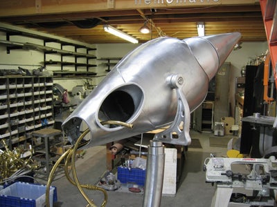

Perhaps the greatest challenge of this project was developing the mount that would hold the head. It had to allow for movement on 2 axis, support some weight, and look cool. Eventually I came across part of a motorcycle frame (I think), and welded some bearing mounts to it that i had turned on the lathe. After some messing around with height and distance from the belt mechanism, the new mount was fixed to the top of some more railing sections.

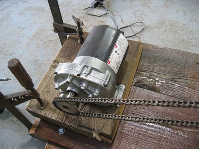

Step 4: Structure

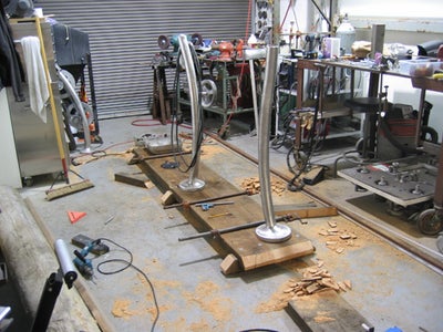

Unfortunately, though it may seem that everything was moving along smoothly, I still did not have any way to support all of this moving mass. The temptation was to bolt each of the three railing support pieces directly to the floor. This would have meant only displaying the piece in places with concrete floors and much agonizing alignment issues at the start of each install. I have learned over the years that a sculpture of this size had better be portable if you ever hoped to find a home for it. What was needed was a base of some kind that would allow me to permanently fasten the three posts and the motor to. Then all other parts could be removed for transport.
Fortunately for me my friend Reuben happened to have some huge planks of wood laying around outside his studio. I decided to go with a sort of sunken pier / ships deck look.

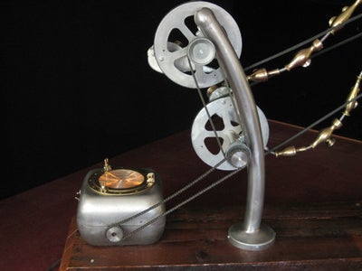

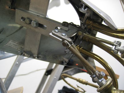

All the lessor tentacles had to be bolted around the mouth opening, leaving room for the large ones to attach inside. I had to machine an adjustable pivot with spring connections so that the head could respond gently to all the random stresses that the motor would produce.

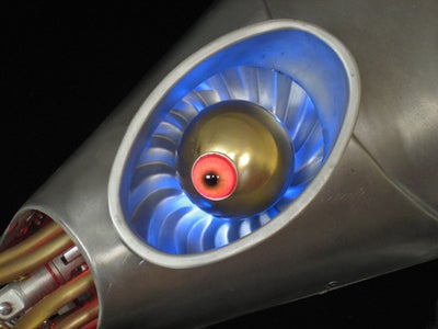

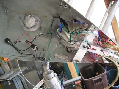

I ordered some glass taxidermy eyes to mount in the brass candle holders to give the beast a little more soul. Tiny LED mounts were machined behind the eyes to make them glow. The inside of the mouth got the same treatment.

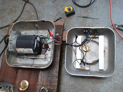

the motor was concealed with the help of lamp pole base covers, and a timing device was installed to keep it from running constantly.

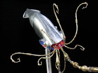

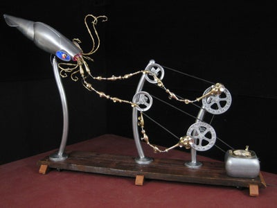

Step 6: Results

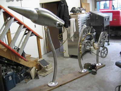

And here it is. It is difficult to convey all the details and size of this thing. There are a few detail shots attached here, but the video on the intro page probably describes it best. Better yet, visit my website for a higher resolution file.
