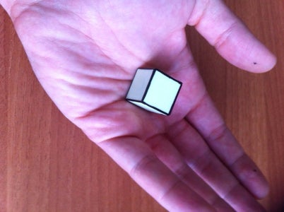

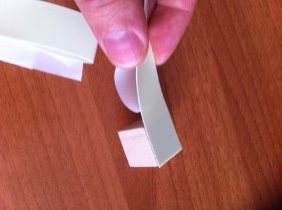

Carefully place the adhesive tape on the wooden block,trying to follow the sides.
Then remove the excess tape. Do this once per each side.

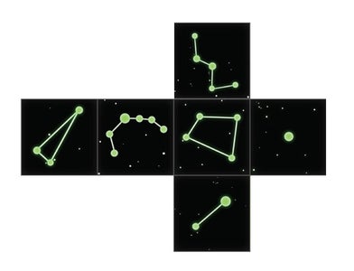

Step 3: Know Your Angles...

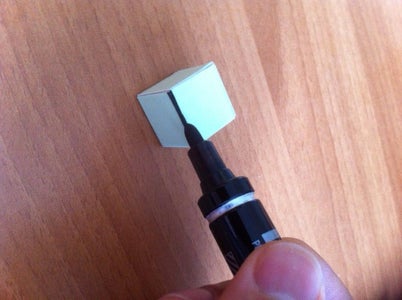

Use a thick marker to paint the little space between two close faces, this is what it will look like.

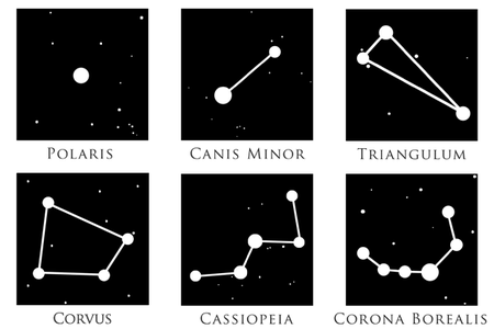

Step 4: Print This Page...

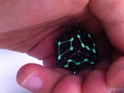

This is what you'll have to draw on each side. Follow the order in the opened cube. Each face has been accurately designed to be recognizable, inspiring, and unique:
1) Polaris is the North Star, around which all the Constellations revolve.
2) Canis Minor is the only ancient Constellation comprised of just two stars.
3) Triangulum Constellation was first described by Babylonians in 1000 B.C.
4) Corvus' brightest stars form a distinctive quadrilateral in the night sky.
5) Cassiopeia is the iconic pattern named after a greek Queen of great beauty.
6) Corona Borealis, whose six brightest stars form a shiny crown.

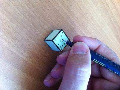

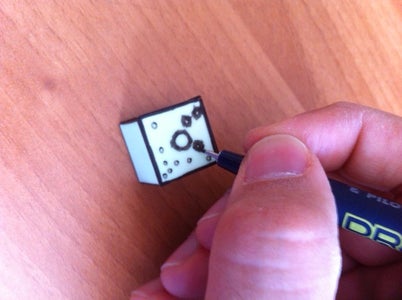

Step 5: Have Some Fun!

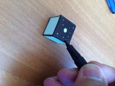

Start drawing the stars using the marker, and fill the white space around the circles first. When all the surface of one face is covered, use a thicker marker to reinforce the black paint. This is necessary because the luminescent surface is usually a bit oily and the ink does not stick.
Give each side some time to dry, and be careful not to smudge the ink or to stain your fingers. If you do, rest assured that all the other sides will share some of the ink with your fingertips!

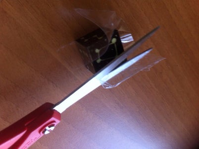

Step 6: For Some Protection...

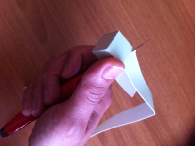

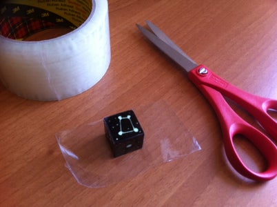

Open some scotch tape on the table and carefully press the cube from the top. Then raise the tape on the sides, positioning the scotch tape in a U shape. Cut the excess tape with some scissors or sharp blade.
Repeat the above steps by pressing what was the top side on another piece of scotch tape, and cover the remaining two sides, again shaping the tape as an U.

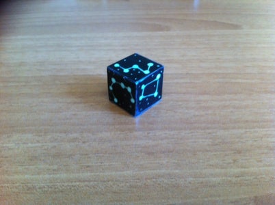

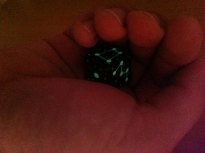

Step 7: Ready to Glow!
Use your nails to remove all traces of air from under the scotch tape, and clean any remaining tape on the corners.
You are quite done, and it works!! But, if you don't really want to go through all this... check the next step!
