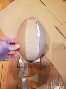

Once you have the carboard cut to shape pre-bend the sheet so it rolls evenly and wrap it so it fits around your face. The bottom nasal bone pieces are going to roll all the way around to touch each other underneath creating the “skully nose tunnel” (or nasal bone and premaxilla for you sciency types)
Step 4: Handheld Napalm Dispenser
Plug in the hot glue gun to preheat. Once it is finger scorchingly hot the magic happens.
Roll the skully nose tunnel up and glue at the bottom.  Hold it until the glue cools down, it will be hot and you will likely get burned but Orc style takes commitment.
Dart the top of the skull in 3 places to allow it to conform to your still human face a little closer and glue those together. Your fingers will be tougher by the end of this.
You can make it a little easier to wear by adding in a “skull cap” of carboard along the top and glue that in. It is not 100% necessary but we found it does help the skull from falling down and blinding you mid axe swing.
