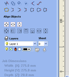

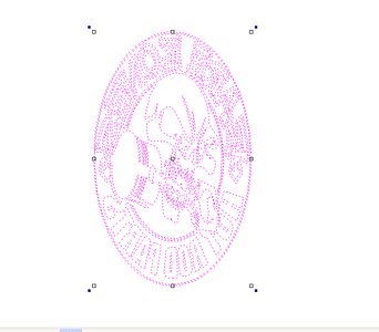

You need to do a few things to the image so its in the right format for the laser cutter.
  1. It needs to be turned into a line drawing.
  2. It needs to be the correct size.
  3. It will need to be mirrored
  4. If your making a clock it needs a 8mm hole for the clock motor to bolt to
  5. It may also need a clear boarder, for the laser to cut material to size.
  6. And it needs to be save as a DXF file.
There are many free programs that can do this (inkscape for example) But I'm going to use Vcarve.
If you click on the images you will find notes on what to do for this step. You may be easier to mirror the image before you start rather that flip the image in Vcarve as shown in this step.
