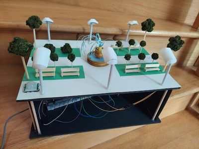

For the first step in building our diorama, we built the area around Buckingham Fountain. The reason we are building this area to resemble Buckingham Fountain is that we want to replicate how it looks compared to the real Buckingham Fountain in Chicago. This is because when we start collecting data, we can get accurate data readings that should resemble the ones in Grant Park.
Some objects we added to make the diorama look close to the area around Buckingham Fountain are benches, bushes, lots of trees, a sidewalk (that is illuminated with lights), and a layer where we can put all of our electronics.
To make the benches we cut a 6cm by 5cm rectangle in blue construction paper and folded it in half for the back part to stand up. After that, we super glued the bottom part of the bench to the “grass” To make the bushes we crumpled a small bit of green construction paper into a ball. To make the trees we used another green construction paper ball and glued it on top of popsicle sticks. For the walkway and Grass, we used green and grey construction paper. The way we made the people and the Buckingham Fountain is by using legos.
Step 2: Add Lights
For the second step, we start creating the sculpture of the lighting and making sure that the extension for connecting our LED can fit through the poll of the light and shine out at the top. We also used black construction paper for the shielding of each light pole.
For our lights, we used single-colored yellow LED's because an amber/yellow colored light is typically the best-colored light in order to mitigate light pollution. On top of that, we need to have shielding along with our makeshift lights because with shielding the lights aren't pointed at the atmosphere and are instead pointed at the ground which helps decrease light pollution.

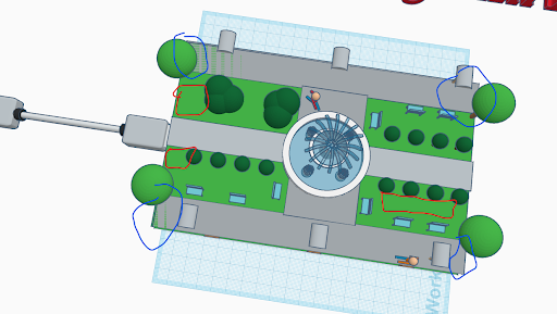

Start bringing the sqm, RGB, and motion sensors to the top of the diorama and place the sqm and RGB anywhere on the red areas (refer to the first picture), and motion sensors anywhere on the blue areas/somewhere on the sides of the sidewalk.
These sensors allow us to collect data on our diorama which helps us know if it's "day" or "night" time. This helps the sensors change the brightness of the LED's so that a more suitable amount of light is emitted. For example, if there are people walking on the sidewalk, our motion detectors will go off and cause the LEDs to brighten. When the people pass by the motion detectors on the sidewalk, the lights will start to dim and stay in the dimed position until another person triggers the motion sensor again.

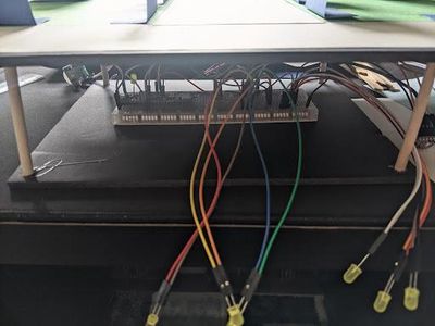

- Common problems: Data isn’t being read. If this is happening, check that all pins are correctly placed on the breadboard.
Second common problem: Code doesn’t upload. If this happens, check that nothing is causing a short circuit and try pressing the program button on the teensy.
Third common problem: Nothing changes after uploading code. When this happens, if nothing is showing on the console/serial monitor, check if all the pins are correctly placed and that the code was uploaded. Press the program button if necessary.
Step 6: Attach Wires From Sensors to Lights
Take the wires that were previously connected to the sensors and plug them back into them.
