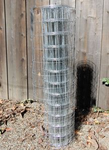

2. Wire Mesh: If you have leftover welded wire from a previous project then this is a great reuse for it. If not, then just stop into your local hardware store or go to an online to buy some. Two barrels stacked with brick or cinder blocks underneath will be around 3.5 feet tall so try to purchase wire a bit taller than that. Be sure the openings are large enough to allow vines to grow trough. You'll also need cinder blocks or brinks, a downspout elbow joint, a short length of hose, and a metal saw if you don't have one already.

Wrapping the wire around the barrels shouldn't be very hard at all.
1. Simply roll the wire out and around the barrel until the ends meet. Bind them with stray bits of wire (paper clips will do) and gently push down until it is slightly set in the ground and stable.
