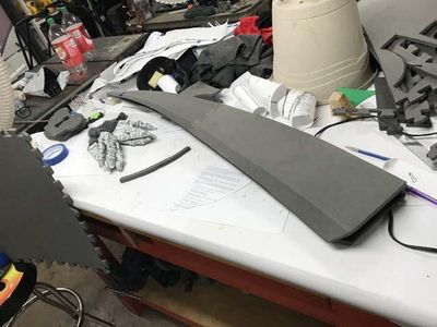

Step 4: Scythe
You can't be the grim reaper without a scythe. From the start I was thinking eight feet tall with a four foot long blade. I wanted this to be huge. With the additions of the stilts, the blade would still be taller than I was, which worked. I originally was thinking the handle would be 3/4" PVC, but with the addition of stilts, the 3/4" PVC isn't large enough to help me balance. It bends and flexes under my weight. I had 2" PVC on hand and drawing it in Sketchup, the 2" handle scales better.
The cross handle and blade is 3/4" PVC. I did heat up the end of the PVC for the blade to flatten it. I used a coupler and drilled out for the cross handle. Another coupler was used at the top. I drilled a hole at an angle to catch the blade. I wanted the PVC to go completely through the coupler for stability.
The main blade is EVA foam. I cut a 45* angle on the inside of the foam 3" up the length of the blade so the bottom angles in to a point. I used contact cement to attach the foam to itself and to the PVC skeleton with a 1" foam spacer at the top to account for the 3/4" PVC. Wear a respirator when working with contact cement.
I was going to cover the entire post in foam, but that requires a lot of foam. I ended up using craft foam for the top half, and painting the PVC for the bottom half. I layered the craft foam at the couplers for a smoother transition. Heat treat the foam before paint. This seals it so it absorbs less paint. You'll know it's sealed when the foam changes color.
I painted the whole thing with black plasti dip. The blade I painted a gunmetal silver, and then on the blade edge sprayed bright silver. I misted a bit of brown and burgundy on the blade to give it a dirty look. For a bit of dirt I hold the paint can farther away and only do a few quick squeezes of the trigger. Go slow with weathering. It's easy to go too fast and too much. The good thing is with weather is that you can wipe if off and the smears can add to the look.
