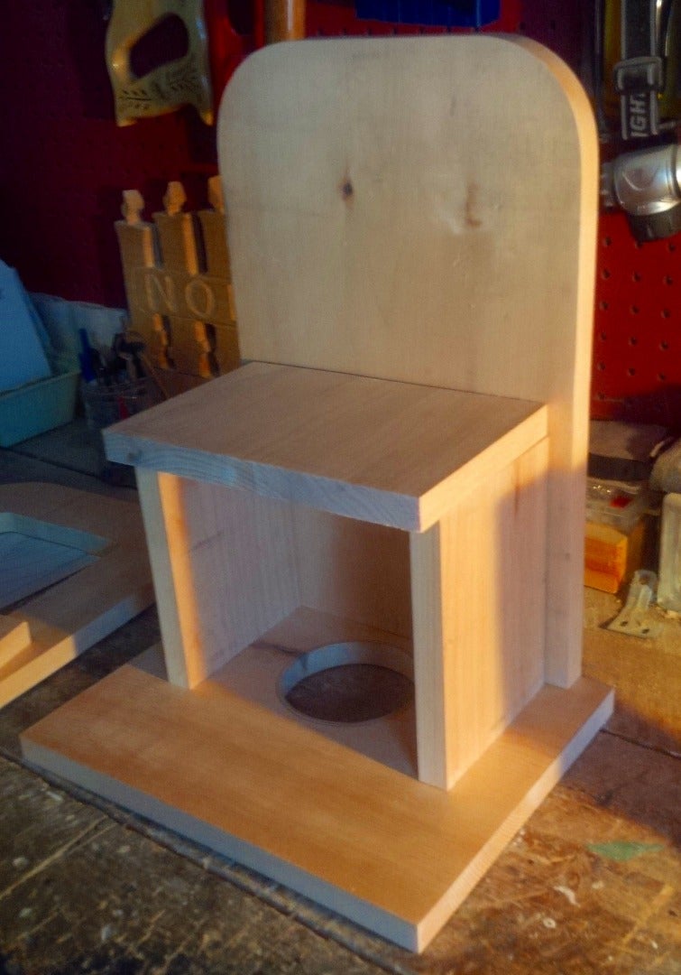

As with other radios I've made the front face is larger than the back face so that the cabinet casing won't be visibly attached to the front.
The subwoofer speaker is placed inside the interior box and ported (vented) to the back and uses the same cardboard tube that was used in the original 2.1 speaker set.

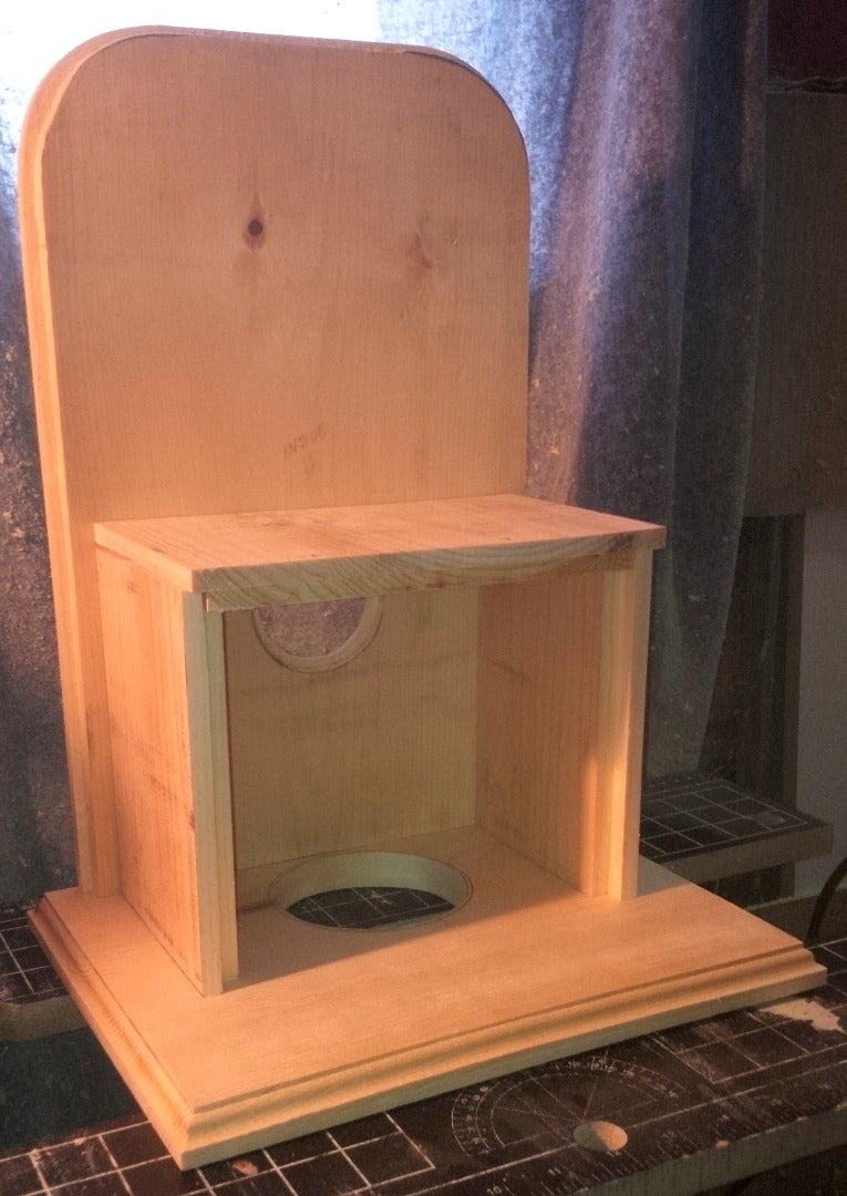

To join the subwoofer box pieces, I used a straight router bit to form a rabbet joint on each edge and then glued and brad nailed each section.
Since the subwoofer's vent is going out the back face, I had to mount the vent tube to it inside and so I also used the straight router bit to carve out a mounting place for it to be glued into place.

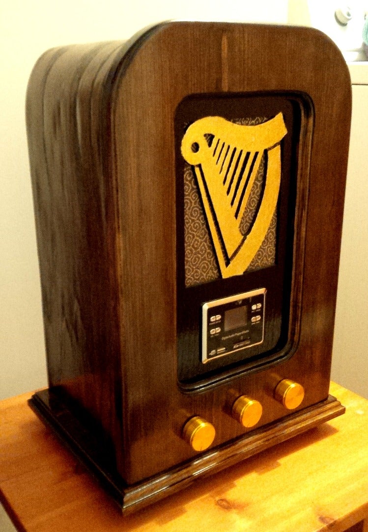

The front and back faces as well as the base of the radio can now be stained. I applied two thin coats of Minwax and three very thin coats polyurethane sealer.

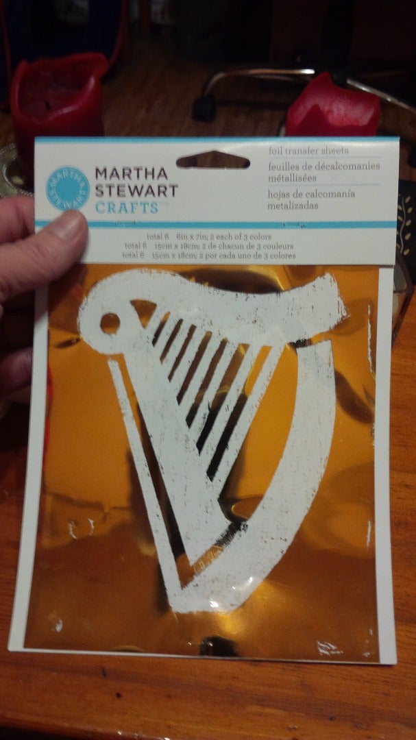

The grill was sprayed black and, using Martha Stewart gold foil, apply the adhesive to the area you want covered, place the film and use a popsicle stick or other form of straight edge to help the transfer. Remove the backing and, voila, you have a golden Guinness Harp. I then applied sealer to this so the foil won't rub off (I don't even know if that can happen haha)
Be very careful to get a smooth surface with the foil adhesive as the foil will show any imperfections through it. (You may notice with mine, that the foil looks a little rough)

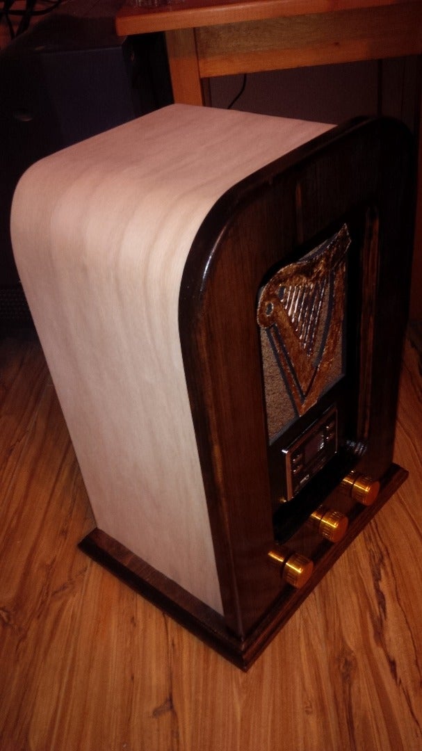

Since the Guinness radio has a subwoofer and is so tall, I thought it would be a good idea to add a lateral brace to the top from the back to the front faces. I routed the edges of this brace so the casing could be attached to it for support as well.
I then added the side portions of the casing. The rounded portions of the casing are kerf cut so that it can be bent into place (with the help of a warm water soak for about 20 minutes). These casing pieces were glued and then brad nailed into place.
Once the rough casing is installed, and after you have unrolled the veneer so it can relax, you can adhere the veneer (I use pre-glued, iron on veneer) to the case and then mask off the previously finished areas, and apply the same two coats of stain and three coats sealer to the veneer.
Peel off the masking tape and now you are finished.
