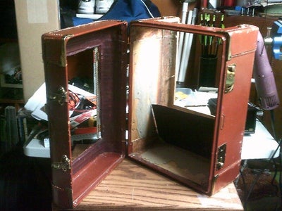

Step 2: The Case Work
Here is the case I found, I needed to remove the handle so it could be relocated later.
More butchery followed.
The open panels were cut with a fine saw so they could be reattached.
