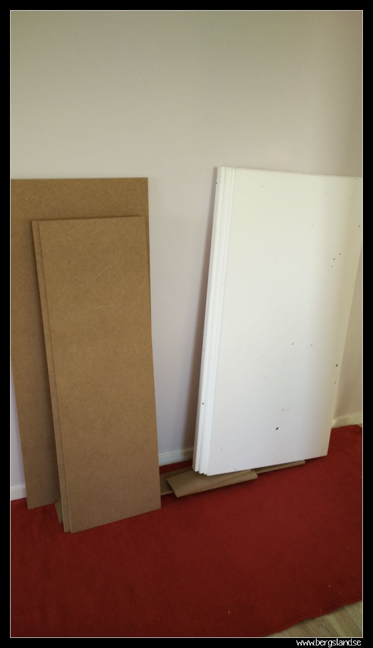

Step 2: Material
Precut (by the wood shop) 12mm MDF, styrofoam and four hinges.
500 SEK.

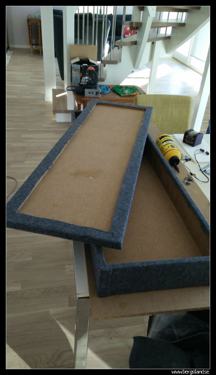

Step 4: Construction
The boards have been glued and screwed together.

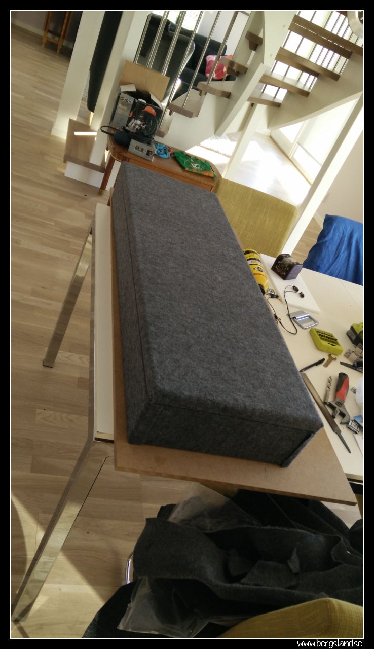

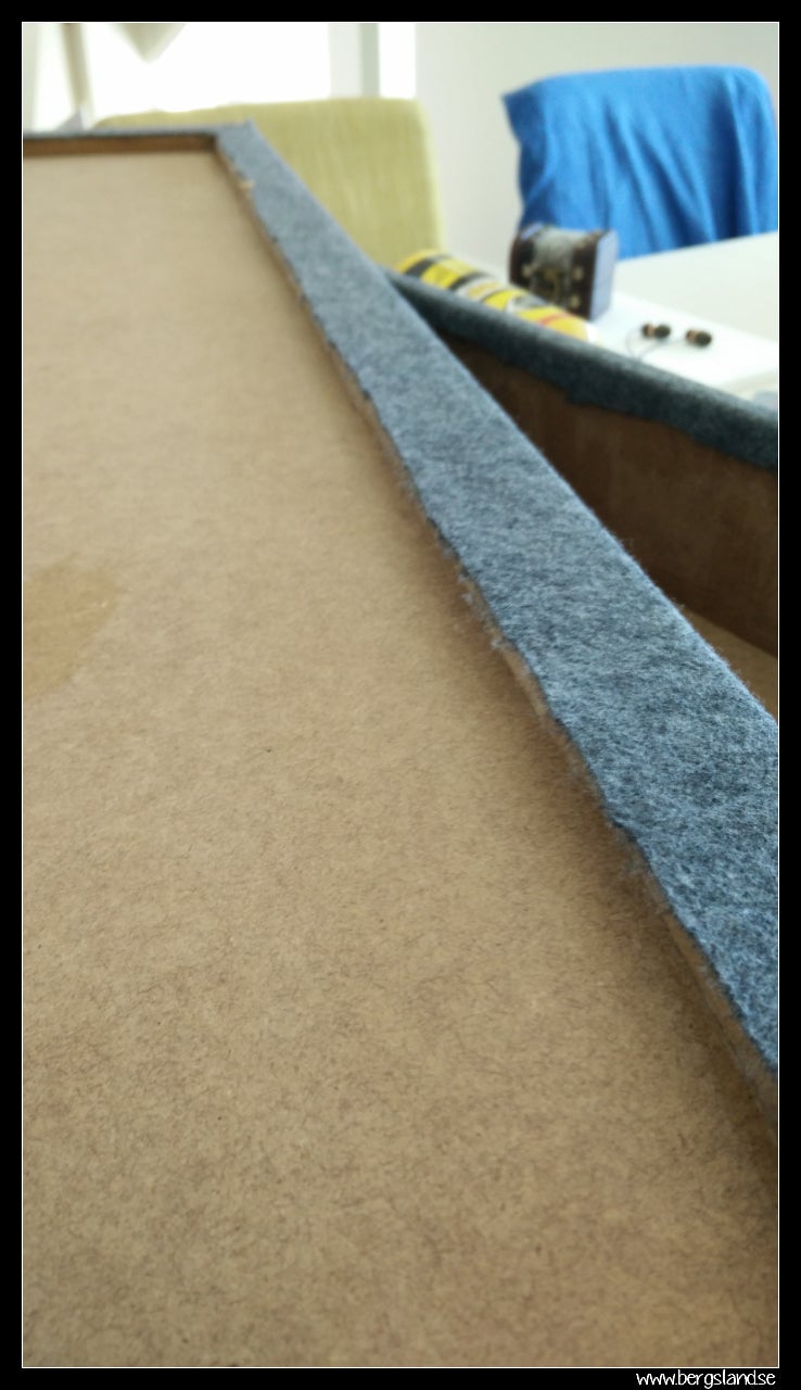

Step 6: Draping
The box and lid has been draped with some woofer fabric I had from other projects. I used wood glue (PVA).

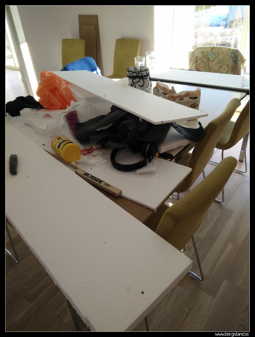

The styrofoam is cut with a knife and a soldering iron and is glued with wood glue (PVA).

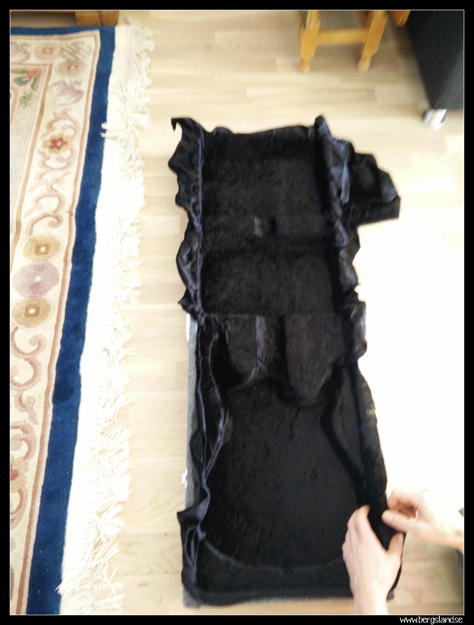

Step 9: Draping Inside
This is where I'm almost breaking my budget. Cloth 100 SEK and spray glue 300 SEK.
Not a perfect fit but it works.

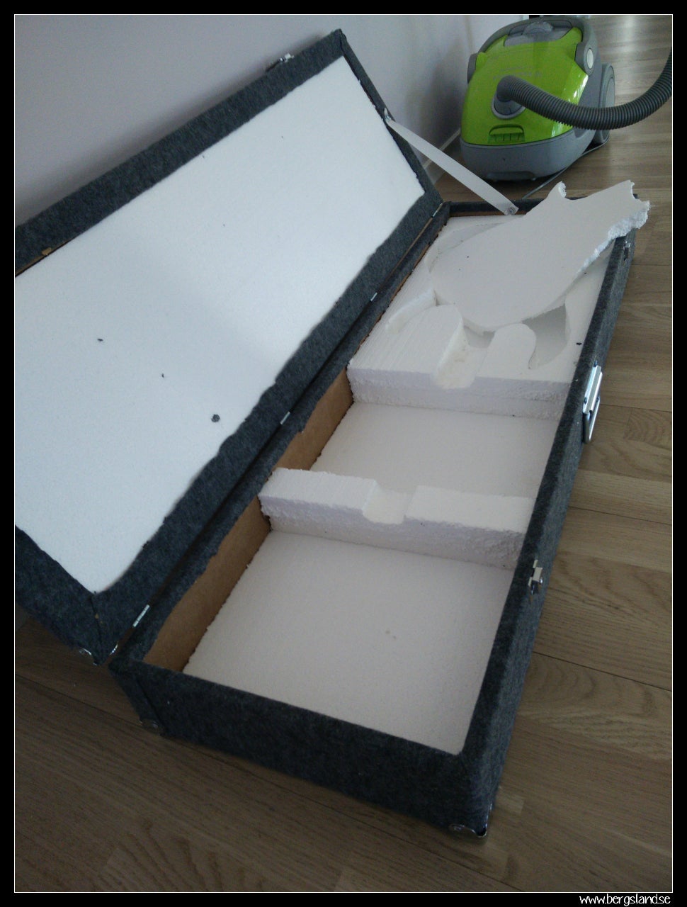

Step 10: Result

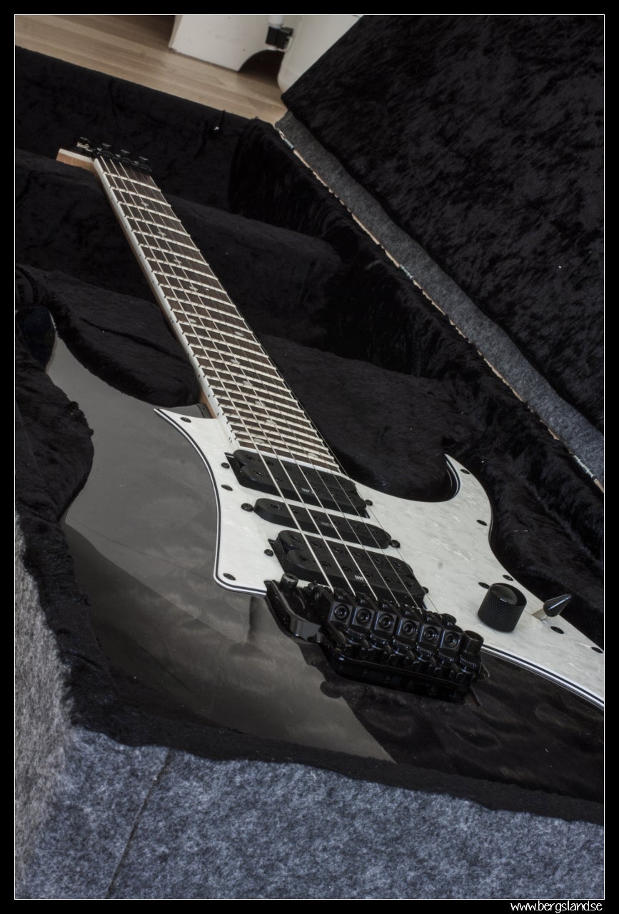

And this is the result, the guitar fits snugly. The case is a bit on the heavy side. But I think it could take some punishment.
The total was 1137 SEK but I had some of the stuff lying around.
