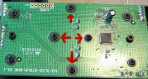

Step 1: Prepare Your Guitar Controller.
First of all you need to open your guitar. I used a flat head screwdriver to open mine and worked good.
Once you've opened your guitar you will see the circuit boards, the one we'll be using is in the middle of the guitar where its placed the strumming bar.
We're gonna unscrew the four screws in the middle of the circuit board. I did it this way coz it's still firmly attached to body of the guitar and it serves as a support for unscrewing.
Then we're gonna unscrew the other 4 screws and lift the board.
Step 2: Taking Off the Switch
Once the board is free, turn it to see the other side of it.
Take off the plastic with the holes to free the switches. This plastic prevents the switch to move and break its pins while you're strumming.
Now we melt the solder of the switch we want to fix, try to not delay too much or you can melt the plastic that holds the metal pins.
Take off the excess of solder of the metal pins, otherwise the switch will not open.
Now you have the switch in your hand!
