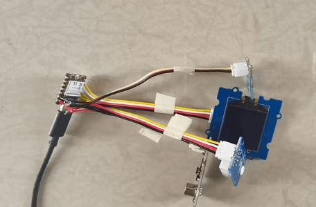

Step 3: Solder Wires to the Microcontroller
Alright, let's get started with the soldering! First, I'm going to cut two of the grove connectors roughly in half. Then, using wire strippers, we'll expose the ends of all these wires. For three of these connectors, we're going to snip off the white wire – it won't be required by our sensors. But for the last connector, the one for our OLED display, we need all four wires because it uses the I2C communication protocol.
Now, I know it looks like a lot of wires, but don't worry! We'll take it step by step. Let's start by soldering bare red and black wires to the VUSB and GND pins on the microcontroller.
Next, we'll grab the yellow wires from those three connectors where we removed the white wire, and solder them to D0, D1, and D2.
Then, for the OLED connector, we'll solder its white wire to D4 and its yellow wire to D5. Finally, we're going to connect all the red wires together and all the black wires together.
If you're feeling a bit lost, take a look at the circuit diagram while soldering.
To keep everything organized, I've labeled each connector with masking tape, indicating what component it will connect to later. Here's a reference diagram for you to do the same.
The good news is we don’t need to do any more soldering. We can simply plug in our components using the connectors, just matching them up with the labels.
Step 4: Test Your Connections
At this stage, I went ahead and uploaded the code to the microcontroller to test if everything worked as expected.
In a nutshell, the code's job is to figure out how "comfortable" the environment is. It does this by looking at the air quality, humidity, and temperature data from the sensors. The code has pre-set "comfortable ranges" for each of these readings.
Then, it checks how many of the sensor readings are currently outside those comfortable zones.
Based on this, it calculates a "comfort score." This score ranges from 0 to 4. A score of 0 means the best comfort level, while a score of 4 indicates the worst comfort level.
Now, it might seem a bit backwards at first, but the score basically indicates the height of the eyelids in the downward direction. So a higher score will mean the eyelid is lower.
