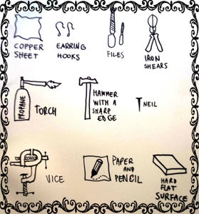

Step 1: WHAT YOU NEED
MATERIALS:
-copper sheet;
-earrings hoops;
-beads (optional).
TOOLS:
-iron shears;
-files, fine grain and rough grain;
-propane torch;
-hammer (with one edge sharp);
-one sharp nail;
-vice;
-paper and pencil;
-hard flat surface.

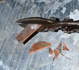

Draw a leaves shape on a piece of paper, than surround it with a rectangular shape.
Cut that shape on the copper sheet.

Step 4: CUT IT IN a LEAVES SHAPE
Draw the leaves on the piece and cut it.

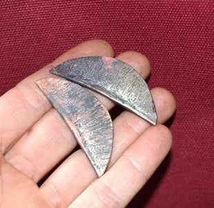

Step 6: HAMMER THE LEAVES
Hammer the leaves with the sharp part of the hammer.
-Start from the center part of the leaves and go up, then from the center down, perpendicular to the fold.
-Avoid to hammer the fold.
-As more you will hammer it as more the leaves will be twisted and have a texture when you will open it.

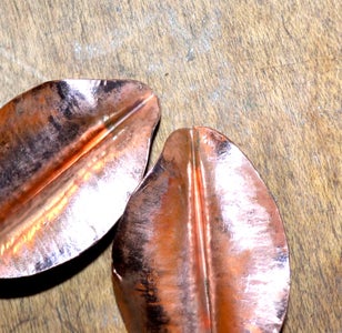

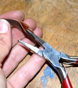

Step 8: OPEN THE LEAVES
Open the leaves, been careful not to scratch them.
Step 9: ROUND ONE EDGE
File down again the sharp edges and round one edge of the leaves.
Step 10: POKE AN HOLE
Poke an hole with the nail and the hammer on the edge you just round up.

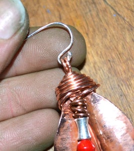

Step 11: ADD THE HOOKS
Add the earrings hooks directly in the hole or add some wire and beads if you like.
