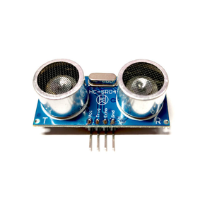

There are multiple versions of the HC-SR04 sensor: In this project, I show one that operates at 3.3-5V volts and one that only operates at 5 volts. The main difference between the two versions is of course the voltage level at which they operate. The setup of using either sensor is the same. I have another tutorial where I show how to use these with the Raspberry Pi Pico (here). However, in that tutorial, I used the 5V version, which should not be used with the Pico...
The Plus version is useful in applications where the microcontroller or microprocessor operates at 3.3 volts. It can be directly connected to the microcontroller's GPIO pins without the need for level shifting or voltage regulation. This makes it easier to integrate into projects that use 3.3V logic. This is great for the Pico, Pico W, versions of the Arduino, ESP32, and more!
The 5V version you see in the second photo is more common and is useful in applications where the microcontroller or microprocessor operates at 5 volts. It can also be directly connected to the microcontroller's GPIO pins without the need for level shifting or voltage regulation. Level shifting refers to the process of converting a signal from one voltage level to another. This is often necessary when connecting two circuits that operate at different voltage levels. For example, if you have a circuit that operates at 3.3V and you need to connect it to a circuit that operates at 5V, you would need to use a level shifter to convert the 3.3V signal to a 5V signal. Note that the Plus version can also be plugged into the 5V microcontrollers because it has a built-in voltage regulator that makes your life a lot easier!
