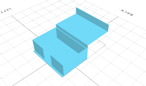

Step 6: Extrude the Bottom Corner Edge
Next, we will opt for the edge selection and select the bottom corner edge of the cube as shown in the image. Then from the modify category, select the extrusion tool. Set the amount to 65.
Step 7: Extrude the Selected Edge Again
Now, choose the extrusion tool again and set the amount to 104. Then again extrude the selected edge with an amount of 30.
Step 8: Add Thickness to Them and Make Them a Union
Next, select the add thickness tool and set the thickness to 1. Then, select both the profiles and go to the stitch and scoop. After that, make them a union.
