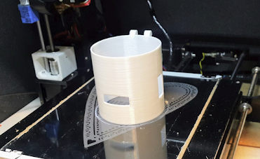

Step 3: 3D PRINTING PARTS
Download 3d modeling files from Thingiverse
Print all parts one by one
  • Brim setting needs at least 1 mm

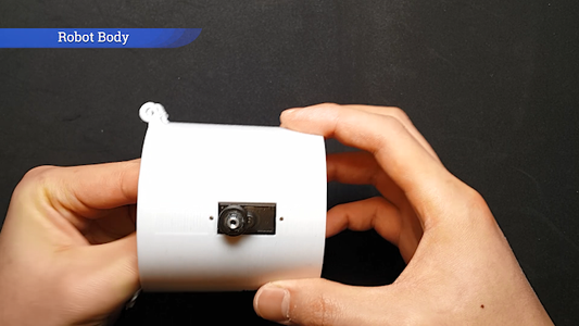

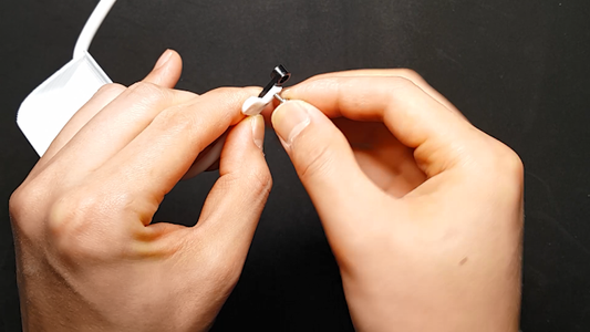

Step 10: Making Arms
The black one is a horn from servo motor. We need to use the screwdriver and screw bolt.
Step 11: Put the Small Part Behind of the Motor
Step 12: Put the Motor Inside of the Body
and fix the motor with the body.

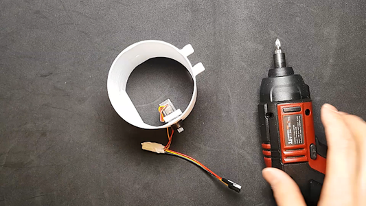

Step 13: Put the Sensor Into the Body and Make Sure the Direction

Step 20: Connecting the Wires
Make sure the color, location and pin numbers
Step 21: Connect Them on the Arduino
make sure the colors
