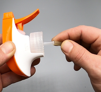

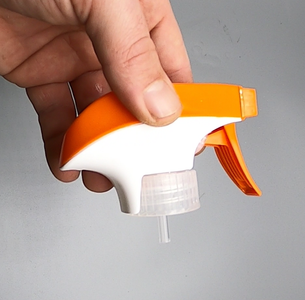

To start, unscrew the spray head from the bottle. Cut the original suction tube a few inches below the spray head. Be careful not to get any splashes of the cleanser in your eyes or on your skin. If necessary, rinse everything well with water and wear glasses just to be sure.
Step 2: Mounting the Flexible Tube
As the title of this step says, we are now going to mount the flexible tube. Slide the flexible tube over the original tube. The flexible tube should be slightly longer than the original total length of the tube.
Luckily I found a tube with 1/8" inner diameter in my shed that fits exactly over the original and closes well. If the tube you use is a bit too small, you can heat it up. If it is too big, you can secure it with some superglue.

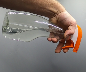

And finished! Just screw the spray head back onto the bottle and you can use the upgraded spray bottle!
As you can see in the photos and in the video, the bottle can now be used in any position. The nuts act as weight. This will allow end of the tube to stay submerged regardless of how the bottle is positioned.
