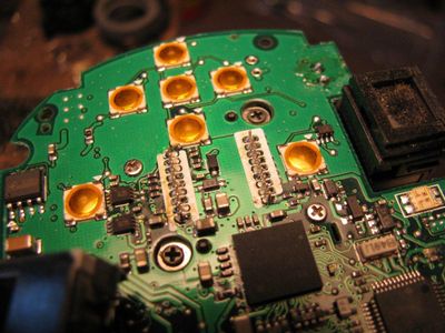

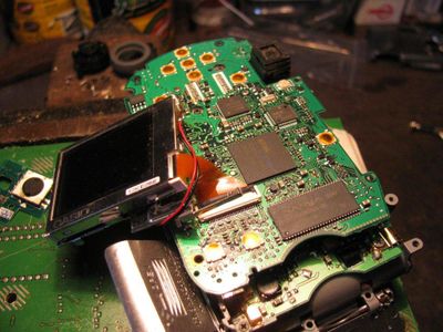

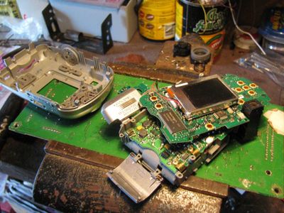

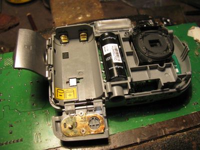

Tear down time! Remember that there is a potential shock lurking in there! Once you get the cover off you probably will want to jump to the next step to see how to discharge the capacitor awaiting you!

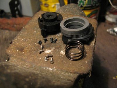

Now, I know most people won't have a camera just like mine, but the concept is about the same - take out screws till you get to the lens.
Just take out every screw you see so that the cover comes off. From there, locate the lens, and try to figure out where it attaches. I took apart my whole lens, but later realized I didn't have to. I did have to unsolder the lcd screen to get to a screw to get the whole lens part off.
Anyway, just take your time and be careful, and you will get it. Just don't ruin your camera by some stupid move!
Take a good look at some of my pictures to get an idea of how to do it.

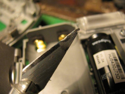

Step 3: Discharging the Capacitor!
Take a look at that picture. There is a nice little shock stored in that capacitor. I was shocked once with a camera capacitor, and I gained a little more respect for them.
All that you have to do to discharge the capacitor, is to short it out by touching something across the two leads of the capacitor. I used a knife, but just about anything that conducts electricity would work - just make sure it is insulated where you are holding it. :)
You can also discharge a capacitor safely by using an appropriate resistor to short the leads.
However you do it, once you are sure all the charge is out of the capacitor, it is safe to move on.

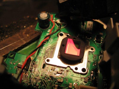

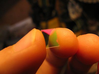

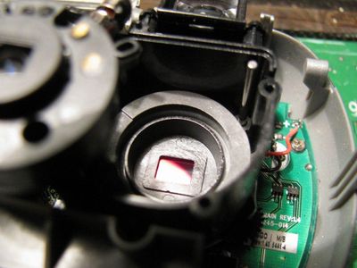

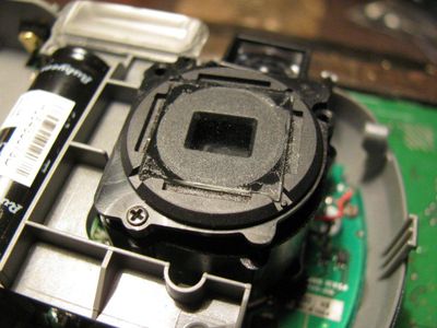

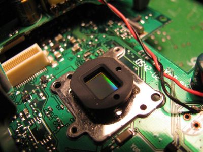

Step 4: Remove the Infrared Shield
Once the lens is removed it is rather easy to spot the infrared shield. It will look like a clear piece of glass that glows red when looked at just right. It should come out easily. Mine was basically just set in a rubber base. Once that is out, your camera should pick up all infrared light!
Some infrared camera instructables put a filter in place of the infrared shield. I did not have any, so I didn't put it in. It works as well as I thought it should without a filter. I don't know what the benefits are of putting the filters in, but you don't need it in there.
Note: It is a good idea to keep the infrared shield in case you need to put it back in the camera, like I eventually did.

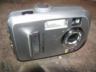

Step 5: Put It All Back Together and Test....
Time to put it all back together. Remember to get everything exactly back the way you took it apart, excluding the infrared shield.

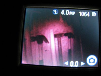

To test it once it is together, simply take a picture in an area with a lot of light, especially outside. The pictures should show up with a distinctive red hue. Also you can test it by shining an infrared remote at it, and see it pick up the bright light.
There you have it, a fully functioning infrared camera!

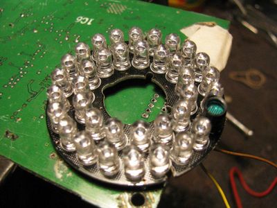

Step 6: Adding the Leds
So, conveniently Amazon has a nice little ring of leds that sells for a pretty reasonable price. Sure you can get them cheaper on eBay or some where else, but you don't get the fast shipping and service Amazon offers. Anyway, although this led ring works great for a flood light effect up close, it is definitely not good for any real distance. If you want long range infrared, you probably will need more powerful infrared leds or either some type of lens to put them in.
All I did was solder two wires (from Christmas lights) onto the positive and negative part of the pcb and glued the ring around the lens hole with hot glue.
Pretty simple in my case, but yours may require a little more thought.

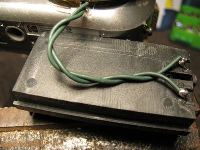

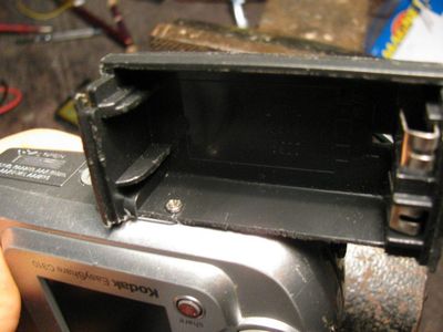

Step 7: And the Battery Case....
To power the leds I chose to use a 9v battery. The case was something I cut out of a RC remote, so I don't know what yours will look like.
All I did was use a longer screw to screw the battery case to the side of the camera using the camera's original screw hole. Pretty simple. :)
