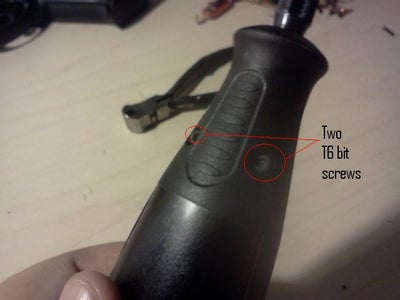

Taking the dremel apart
This is pretty easy to do, just make sure you pull off the power pack and attachments are off it. Once done with those two things you’ll now twist the top off. After that you'll have two T6 screws. TO THE NEXT STEP!!!

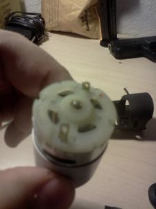

Now that you have the cover off the rest will be just as easy. Pull the whole motor out
(WARNING: Be CAREFUL not to lose the bit locking spring on the housing.)
Then pull off the blue bottom part (should slide off), you should see two pongs one positive and will have red dot next to it. Thus meaning the other one is negative.
