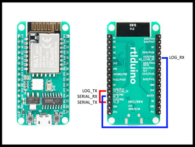

First we need to link together two serial ports of the Rtlduino. These are the Main Serial UART and the Log UART. We can link these two ports using two female-female jumpers on the pins shown in the image. The Serial_RX pin is connected to the Log_RX pin. The Serial_TX pin is connected to the Log_TX pin.

1) Apply two solder blobs to short across the serial port pads linking RX to RX and TX to TX. These connections replace the jumper wires used in the previous step.

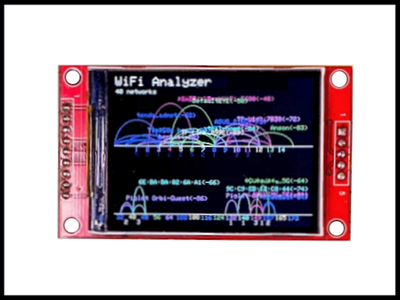

Step 10: Rtlduino - Dual Frequency Wi-Fi Mapping
Grab the attached DualWiFiMapper.ino sketch and burn it to the Rtlduino.
Feel the power of dual frequency Wi-Fi support?
We can now work with both 2.4GHz and 5GHz wireless channels.
