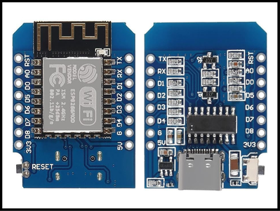

We'll be working with the ESP8266 D1 Mini Microcontroller (MCU) Module to measure the output of the current transformers. The ESP8266 D1 Mini features built-in 2.4GHz Wi-Fi support, an antenna, a USB-C port, and an onboard USB interface chip.
BEFORE SOLDERING the module, let's make sure we can program it and test some things out...
Configure the development tools:
  1. Download an install the Arduino IDE Software
  2. Start the IDE
  3. Open File > Preferences from the menu bar
  4. Add https://arduino.esp8266.com/stable/package_esp8266com_index.json into the box labeled Additional Board Manager URLs. The box can have multiple URLs, just separate them with commas.
  5. Open Tools > Board > Boards Manager
  6. Find and select esp8266
  7. Click the install button
  8. Don’t forget to select your ESP8266 board from Tools > Board menu after installation.
  9. Select Tools > Board > ESP8266 Boards > LOLIN(WEMOS) D1 mini (clone)
Compile and upload a first program:
  1. Open File > Examples > Basics > Blink
  2. Connect the MCU module to the computer using a USB-C cable
  3. Hit the arrow icon to compile and upload the Blink sketch
  4. The blue LED on the MCU module (next to antenna) should blink slowly
  5. Experiment with the delay values in the sketch to demonstrate different LED timing patterns
