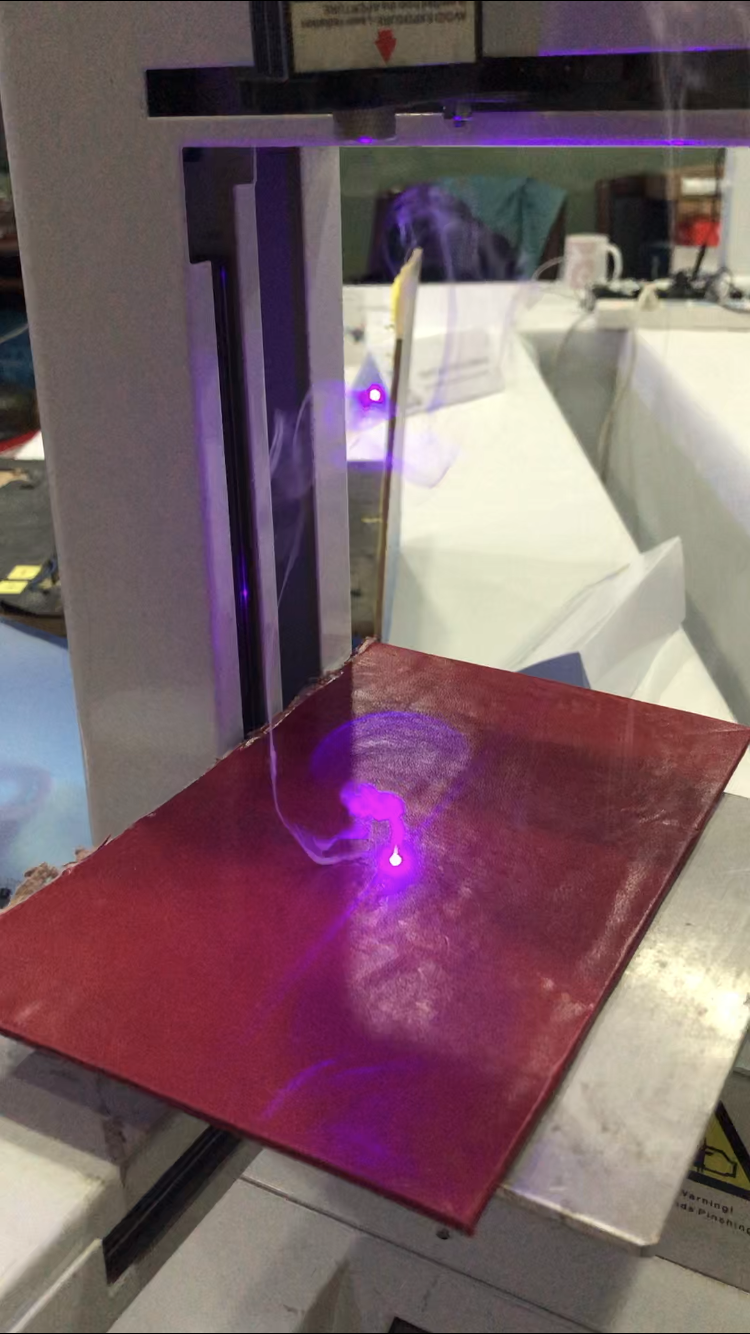

Step 1: Laser Testing
First step before we start is to check our laser module. We connected a 12V 1A charger with the module and tested the laser. It has an adjustable focus which we can alter according to the distance of material from laser.
It is important to adjust the focus accurately otherwise the laser will not engrave on the material underneath. (Focus adjustment varies from material to material and can be changed manually)

Step 3: Fixing Laser Module
Now to fix the laser module on the printer, we decided to use some L-brackets to connect the laser in the existing empty extruder slot of the printer. We powered the laser through an external power source however you can connect it in place of the fan port of 3D printer as well.
(Here it is important to note any changes that might result due to an offset while printing designs because of the L-bracket or any component that you may use to attach the laser - as it might not fix exactly in place of the extruder. In that case, you can adjust the offset by altering measurements for X and Y while creating your design in the editing software)

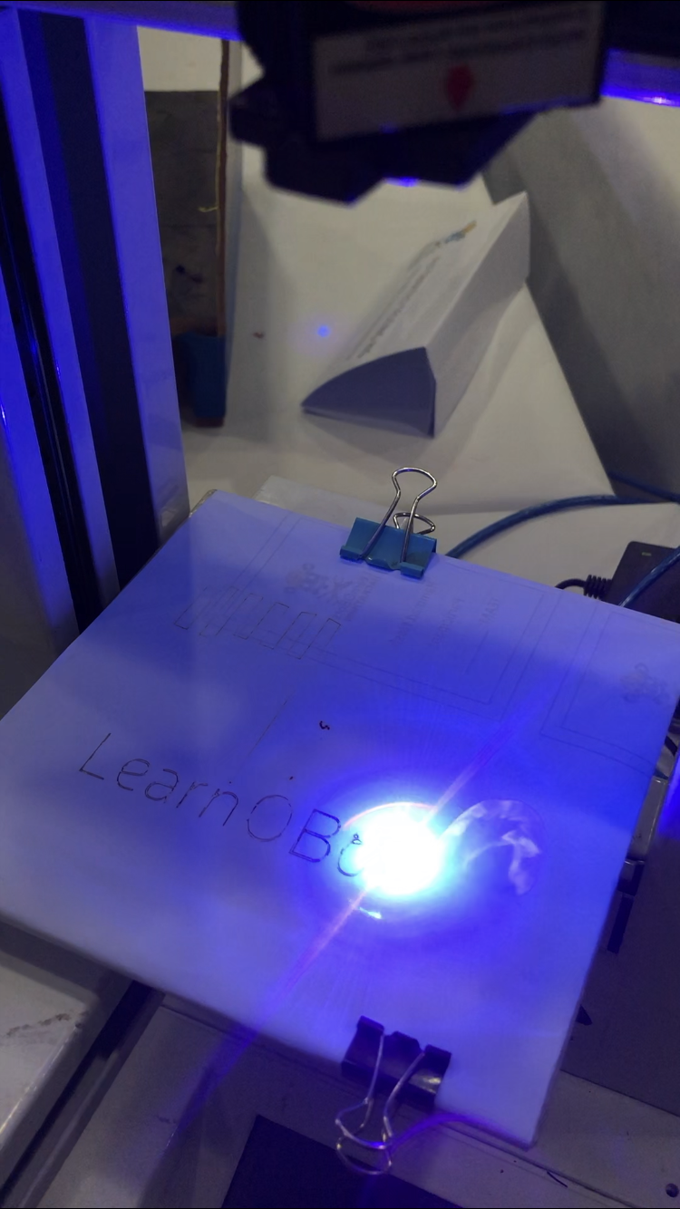

Step 4: Start Engraving
For selecting the software to create our designs, we checked if our printer worked with “Pronterface” but we weren't successful in connecting our printer through Pronterface, so we had to use "Doraware" (it has many limitations and you can't play around the G-code once it is generated. But since our printer had a damaged SD card slot we had to upload the design directly to the printer which could only be achieved through Doraware for IdeaWerk)
We used InkScape software to detect the edges of the picture to engrave and saved the file in SVG format. Since Doraware only accepts STL files, we used TinkerCad online to convert SVG file to STL and opened it in Doraware (You can use any other tool for conversion as well). Don’t forget to set zero degree temperature for extruder and bed. Also uncheck the Raft option and click on Generate G-Code.
