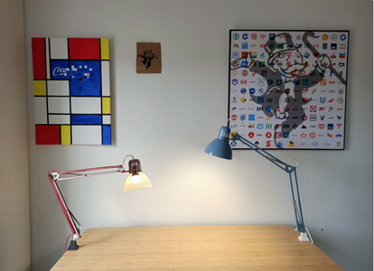

Have you ever seen these scenes in the terminator movies where they are coming back from the future ? You know, where the sphere into which they appear disintegrating everything in its path. This was part of the inspiration for this lamp.
In this instructables, I will show you how I have converted a lighting lamp into a decorative lamp. I have used a relatively cheap lamp, the Ikea Tertial
I chose a color scheme that works fine but, should you try this project for yourself, have fun with it 😉

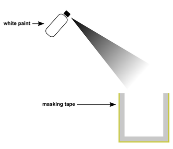

First, we will paint the interior of the C extrusion, cover the exterior with the painter’s tape making sure that you do leave any gaps. In a well ventilated area, you can then proceed to painting the interior of the arms in white (there is plenty of tutorials online showing how to spray paint to get the best results).
Second, once the interior paint has dried, mask the interior of the extrusion with painter’s tape, do not forget to mask the holes drilled in the previous step. Paint the exterior with the black paint.
The third and final steps consist in painting the imaginary “cut line” of the lamp. Painting the cut line highlight the feature. Mask (once again with the painter’s tape) enough on both sides (interior and exterior) of the C extrusion to get a consistent cut line and paint it with paint brush and acrylic red paint.

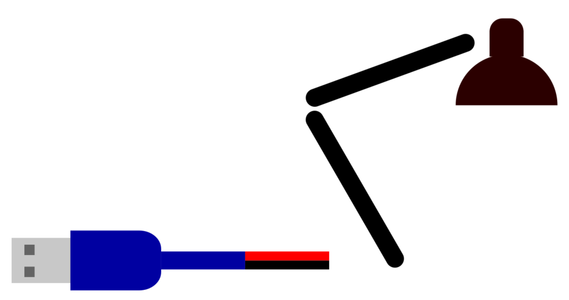

To power the LED, I am using a usb charger (for security reason, you have to use low voltage to power this lamp due to the fact that the lightbulb is open).

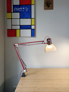

Step 13: Results
