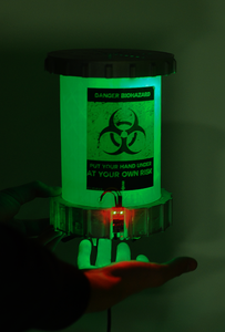

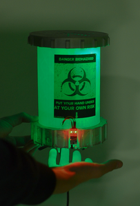

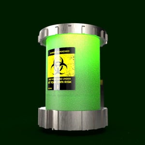

Well, if that's you, we offer the perfect solution without losing the spirit! This project is an automatic machine that works as a candy dispenser by detecting when a hand is placed under. Thanks to its infrared sensor and servomotors, programmed in CC+, the system recognises whether there's a hand or not and if there's one, randomly chooses between two different tanks of candy (good or bad flavour).
But... hang in there! It's possible that if you're lucky enough you could be the chosen one and win a big haul of sugary delights. Plus, its aesthetics match the spooky theme, as it is inspired by experimental storage tanks and hazardous materials with light and sound details, to make it a complete experience.

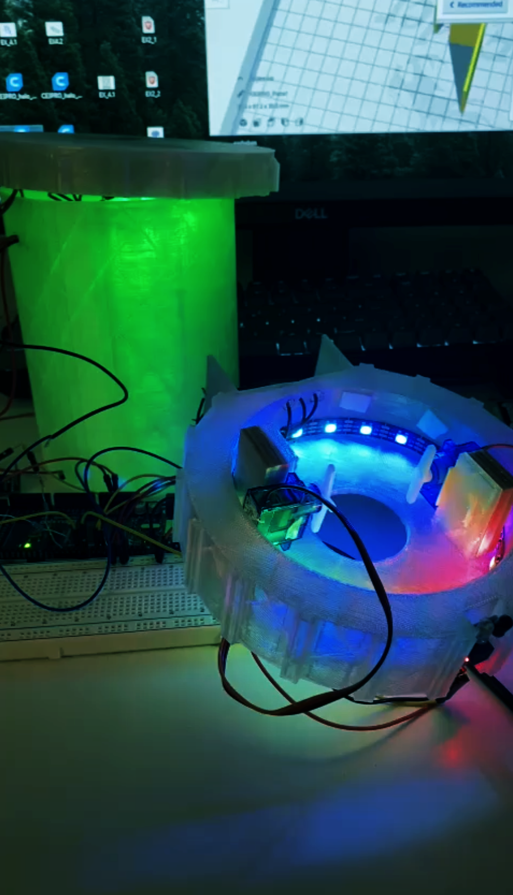

Once we understand how it will work, we need to materialise our idea. We have decided to make a tube structure (halo_medio.STL) with an inner funnel/thinner tube (tubo_caramelo.STL) to avoid the candies getting stuck inside. The lower part (halo_abajo.STL) has two extrudes of material that enables us to glue the servomotors, and the upper part consists of two parts (halo_arriba1.STL and halo_arriba2.STL), which allowed the buzzers to sound better, since they were secured inside and the other part had holes. We used Solidworks for the modelling and KeyShot for the rendering. The files of the parts used by us are also available to you.

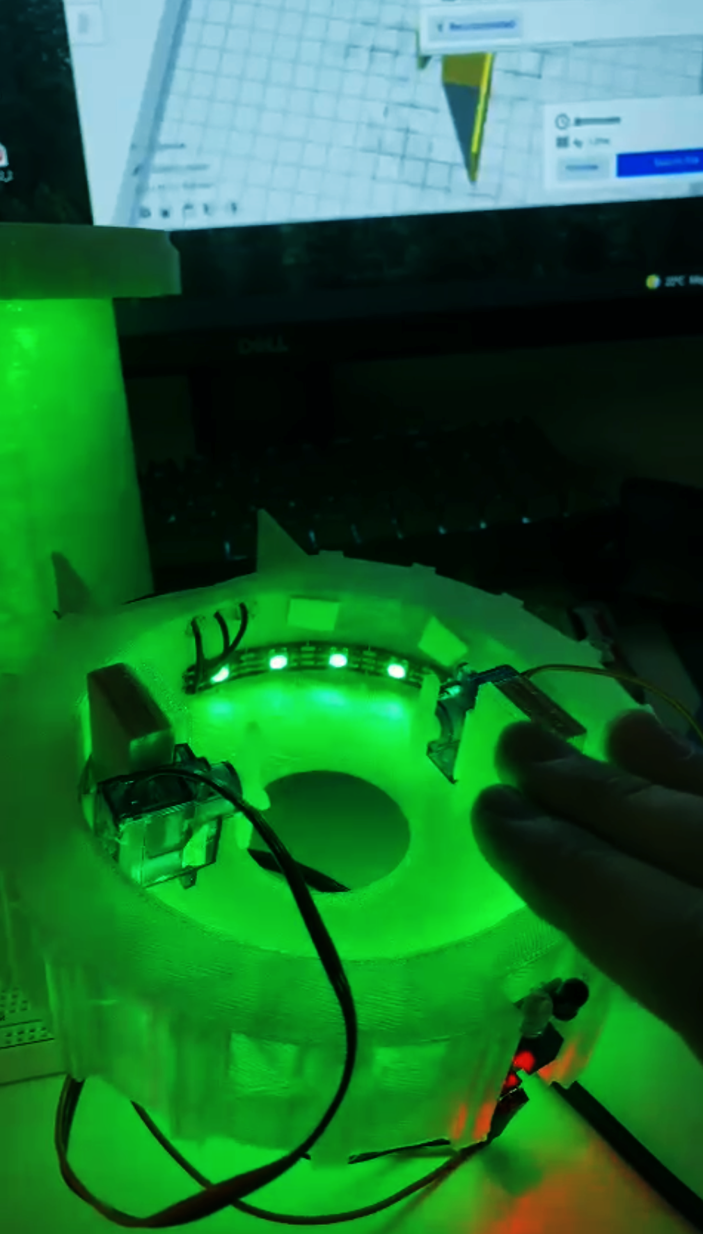

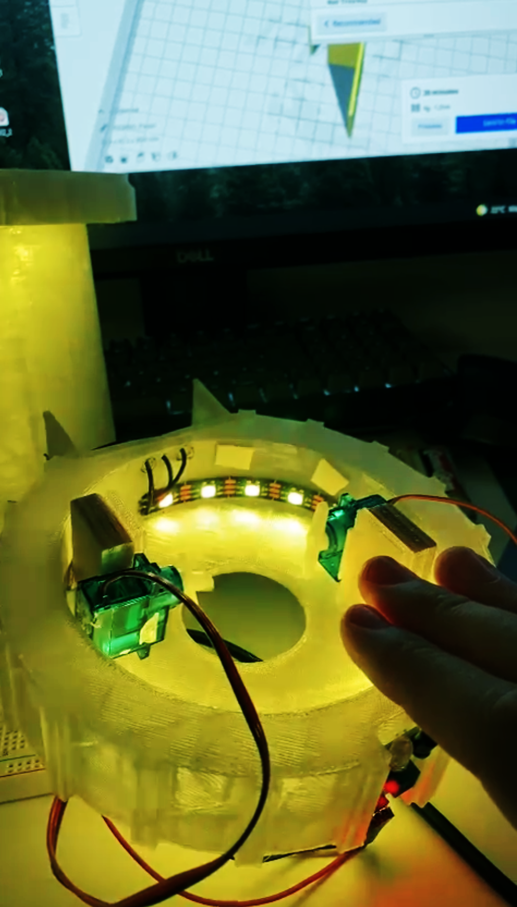

Once the 3D parts are assembled, the candies are placed inside the tube and an inverted "L" shape is joined to the servomotors to regulate the dispenser mechanism. Then, the angle is adjusted (in the code) to make one candy fall each time. Sometimes it is possible that the servomotors do not work correctly and their movements are inaccurate or more abrupt than normal. To check that it is in the correct state, you should use the example provided by Arduino.
Step 6: Test the LED Strip
As with the servomotors, it is necessary to check that the LED strip works in its entirety and then cut it according to your preferences. To do this, download the NeoPixel Arduino library and use its examples to check it works properly. Ideally, after cutting the new strips, they should be tested again to avoid possible errors. We have placed 16 LEDs under the lower part, and 3 on each side of the central part (the "good" and the "bad" candy).
Step 7: Place the Remaining Electrical Components

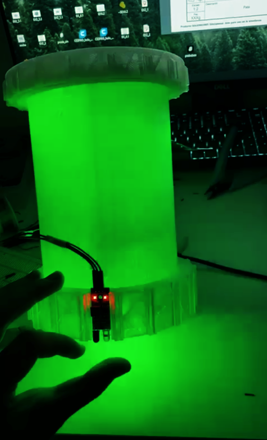

Once the LED's strips and the servomotors are placed, the candy machine should work properly. Yet, to initiate the movement we need to place the infrared (IR) sensor, which should be located in the lowest part of the prototype (halo_abajo.STL), and the distance should be adjusted to where a hand is usually placed. After that, we have to place the buzzers on the top of the second part (halo_arriba1.STL).

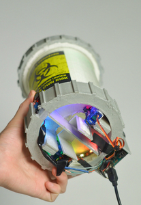

Step 9: Connect the Wires to Their Respective Components and Solder
Now that we have the pieces painted, it is time to assemble again all the pieces and finally solder the wires to the electrical components, so the protoboard would no longer be needed. If the wires you have are not long enough, two wires could be soldered together. One important thing to take into account is that the LEDs strip has a soldering direction (indicated with a ▶), which means that soldering it in the wrong direction would lead to errors.

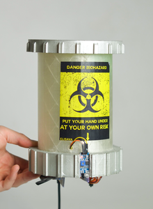

The warning sign has been created with Adobe Illustrator and printed using adhesive paper. The dimensions of it are 800x800mm and it fitted and stuck perfectly to our prototype. We have attached the Illustator file in case you want to use the same template.
Step 11: Final Pictures
The final step was to take some pictures with our Nikon camera in a Photography studio.

Now all you have to do is set up the prototype at your home’s front door to make sure every guest or individual that demands trick or treat candies, gets some without disturbing you!

This project has been far more complex than expected, as the mechanism for dispensing candies was controlled by more parameters than the ones we initially thought. With the original 3D printed funnel structure, we caused unwanted blockages when filling the candy tank, which is why we ended up opting for a cylinder. Once all the candies were falling out, we had to keep testing until we found the ideal angle of the servo to let only one or two candies through.
