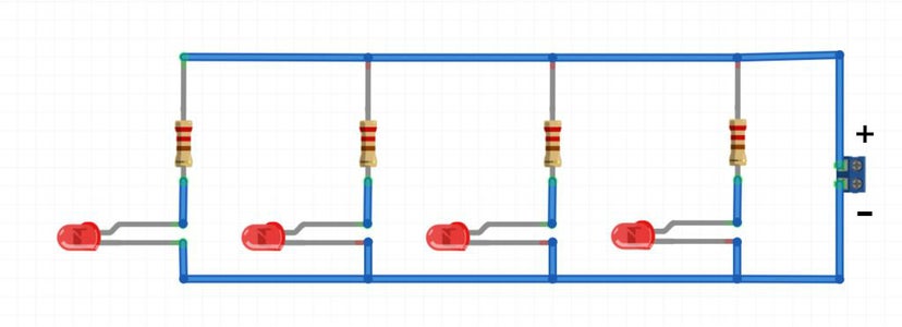

Step 3: Wiring
Wiring is straightforward, each LED should have its own current limiting resistor. We used 1K for my LEDs, you can try lower to make it brighter but probably should not go lower than 220 ohm or you will risk damaging the LED.

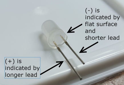

Reminder:
Flat side with the shorter lead is cathode (-)
Non-flat side with the longer lead is anode (+)
If you have a multimeter, use it to test the power polarity, otherwise, just try hooking it up and if it does not light up, reverse the + and -.
We used a header and breadboard to experiment with different LEDs and resistor values. However, this is not strictly necessary as you can just solder everything together.
