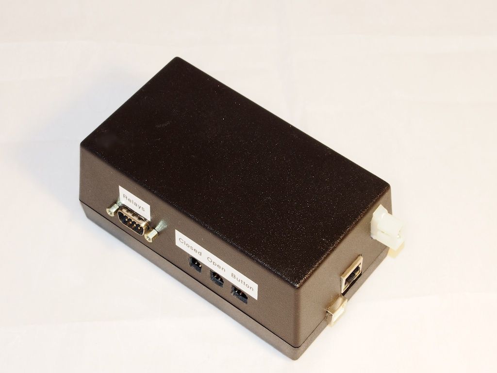

Step 2: Solid State Relays, Outlet, Arduino and Outlet Box
In this step we'll connect the solid state relay and outlet receptacle. Be very careful not to have anything that can short out. The sub-steps is as follows:
- Cut out a notch around ¼" (60 mm) square to allow the cables to the outside of the outlet box.
- Cut about 12" (30 cm) from the plug of the short extension cord (or make your own short cable with an plug).
- Attach the common line of the short extension cord to the outlet receptacle.
- Attach the other line of the short extension cord to one of the solid state relays and add a short jumper to the other relay.
- Attach a short cable from each solid state relay to each of the receptacles of the outlet.
- Attach 4 jumper cables from the relay control. These must be long enough to reach the Arduino which will be mounted on the outside of the outlet box.
- Attached the Arduino to the outside of the outlet box.
- Attach the solid state relay to the outlet box using some standoffs.
- Plug the USB power supply and the short extension cord to the long extension cord.
- Carefully place the power supply and cords in the outlet box.
- Attach both blank inserts to the outlet box.
- Run both the cables for the Arduino and the USB cable through the notch.
- Attach the wall plate to the outlet box.
