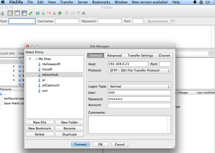

Now if you want the feature of SSH and FTP into the Edison setup the Wifi at the edison prompt
configure_edison --wifi
It takes about 10 seconds for the Edison to scan for Wifi networks and list them as shown in the screen shot above. Type the number which matches with you WiFi router name , in my case "androidpod" is my network name which corresponds to 20 in the list Type in your password, and once done make a note IP address and web url which in my case is http://edisonhub.local/.
In addition you will have to also setup the password for root , use the following commands
configure_edison --password
At the prompt type in the new password and type it again to confirm as shown in the image above.
Now you can SSH from another terminal window using
ssh root@ipaddress of the edison
in my case - ssh root@192.168.0.16
You can also a use a tool/software likeFilezilla to transfer file to and from the Edison, here setup the new site in the site manger as shown in the last picture above.
