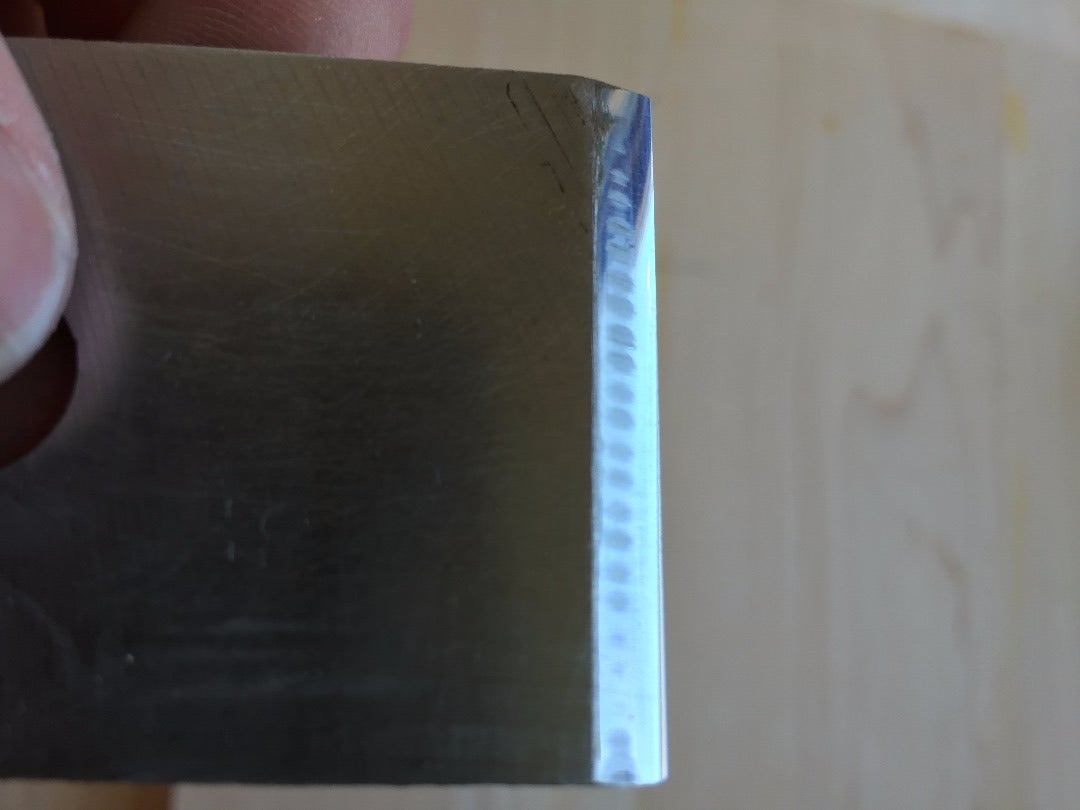

Step 5: Sand the Blade
Repeat the sanding process on the front and back sides of the blade. Don't even bother touching the bevel (the angled, sharp part at the front of the blade) yet.
Step 6: 研ぎます(Sharpen)
From what I understand, those squiggly characters up there are Japanese for "Sharpen". (However, knowing my luck, it's probably some derogatory term that will offend half the world... I digress). Why is there Japanese in this Instructable, you ask? You'll hopefully figure that out below...
You'll need to sharpen the blade most likely, so in that case choose whatever method you want out of the millions there are... But I suggest you use a Japanese Waterstone (Now you get it). Japanese Waterstones are so great because as you sharpen, you are removing old gummed up abrasive, and are revealing new magic sharp rock. If you do it right, you'll end up with a mirror polish in which you can see your reflection, and when I do it, I like what I see ;). You can pick up a two-sided 1,000 grit and 6,000 grit stone for around $30 US. (Buy it, almost all Japanese woodworking products are great).
