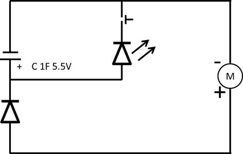

Looked very promising. I designed a circuit to make a hand crank torch. So here it goes.
Step 1: Schematic
The circuit that I got used a capacitor to store the charge that was generated from cranking motor. But I stripped it to just glowing 2 LEDs. I did not find any capacitors or diodes in the circuits.

So now If you crank it clock wise one LED glows and going other ways the other LED glows. I am planning to add the capacitor and the switch the next time I make a trip to the electronic store.

    Aren't geared motors are pretty useful.
    If you add a full wave bridge rectifier, then turning it in either direction can light the LED's, if their polarity it the same.
    Also, instead of 2 LED's with opposite polarity, if you can get a 3-color(?) LED, then turning it in one direction, it'll will glow one color and turning it in the other direction will glow another color -- I forgot what the colors are, and I think AC will make it glow the third color.

    Wow! thanks for the advice. Actually I left electronics long time back! actually 3 years! since my kid is born. He is quite an explorer wanting everything! So I disposed everything including small parts and soldering irons. I planed to make it quite complex! cutting down to the circuits and re-cutting down to do it with whatever at hand. I guess I will put another ible making a very complex one using a stronger more durable box!
