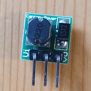

Dc-dc booster module

The voltage from the battery is increased using a module found on line at:
https://www.ebay.com/itm/mini-dc-dc-Converter-0-8-5V-to-DC-5V-Step-UP-Boost-Module-for-Breadboard-Arduino-/271734570473
It increases the voltage to 5 volts output.
Step 2: Fix Into Head-light
Fix the dc-dc booster module into the head-light. Solder a wire from the light to Vo (output), connect a wire from the battery negative to the middle connector, connect a wire to Vi which will connect to a switch and on to the battery positive. Connect a wire to the battery positive which will also connect to a switch.
