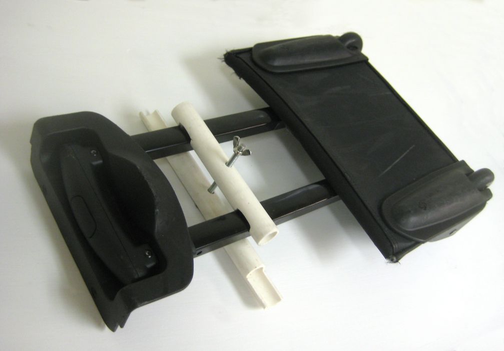

Step 3: Running a Wire From One Headphone to the Other
You'll need one shielded wire that passes from one side of the headphones to the other. I could have gone with the original wires of the audio phones, but I had some 1/8" shielded wire around and it seemed like it'd be nice to use beefier wire for this run. You use shielded wire so you don't end up hearing a lot of buzz and wherr from electrical noise from the tools you're using.
This turned out to be by far the hardest part of the project. But only because I decided to make it hard on myself. If you have headphones like the 3M ones that just have a solid plastic band that goes from one ear to the other I recommend just drilling some 1/8" holes along the band, and snaking the wire up/down though those holes to keep it out of the way and tidy.
The headphones I had were more complicated. They had a two springy steel wires that went between the sides, with a padded plastic band at the top for your head. The wires passed though this thing, and I decided to pass my wire though as well. This turned into about 30 mins of soaped wire and deep tissue massage to get that wire to behave and come out the other side.
It looks nice, but really was not worth it. If you have a small stainless wire or something you could thread that through, and use it to pull the shielded wire though that might work better, but really it wasn't worth it. I probably should have just converted my 3M headphones instead, a few drilled holes and some threading would have been much less frustrating.
Don't be tempted to use gaffers tape or something for this step since your hair is up there and you really don't want something sticky providing depilatory services while you're wearing these things. Also remember to leave enough slack in the wires so they can be adjusted to their biggest setting and also have the ear pieces tilted out to their normal position when in use.
