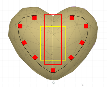

  1. Print out the template and cover the red spots with double-sided tape.
  2. Place the RGB LEDs on the red spots on the template upside down. The four leads should point toward you. Mark the GROUND and VCC pins to make sure you solder them correctly. Face the GROUND pin to the outer ring of the heart.
