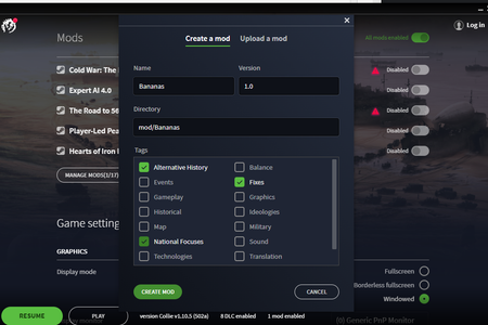

Step 1: Creating the Mod Itself and the Folders
The first and most important step is to create the actual mod folder. To do this, open the game launcher, then go to mods --> mod tools. From there, give your mod a name and check any of the provided tags. Make sure to assign a directory for the folder so you can access it. You can also give a version, so put whatever you want there because it doesn't really matter.

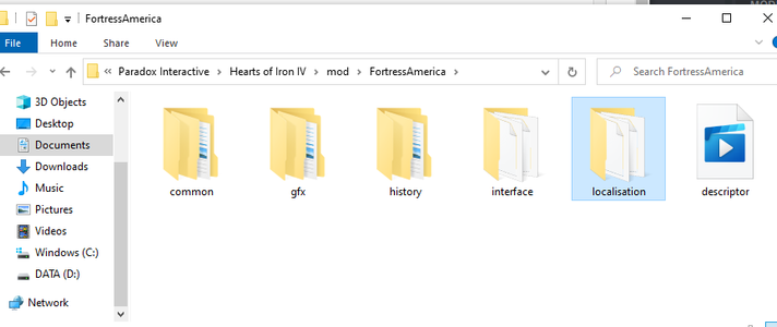

Once your mod folder is created, go to Documents --> Paradox Interactive --> Hearts of Iron IV --> mod
Your mod folder should show up. Now, you'll need to enter your mod's folder and start creating folders. Inside these folders you may also need to create subfolders. For my mod I created the following folders and their subfolders:
common: bookmarks, countries, country_tags, defines, ideas
gfx: flags, interface, leaders
history: countries, states
interface: no folders needed here
localisation: no folders needed here
