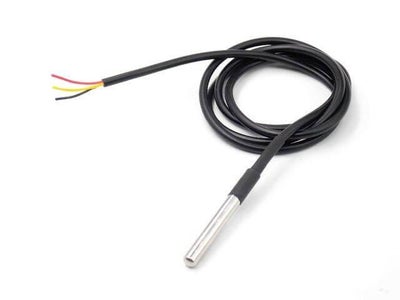

1unit Dalas one wire digital termometer DS18B20

When drilling a hole for temperature sensor DS18B20 and putting inside cooling paste also screwing with a bolt too.

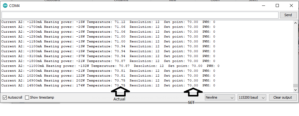

Uploading simple sketch.
Step 7:
Testing and enjoing the warm tea or coffe.
