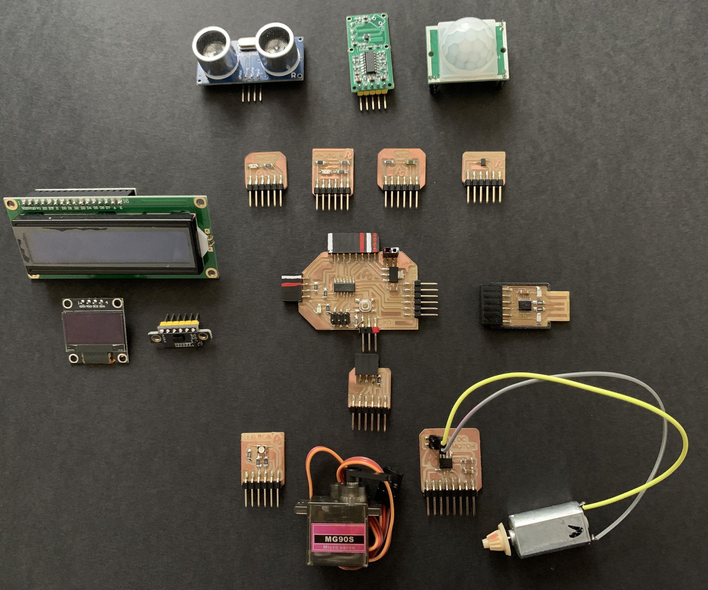

Once I have the board milled, I pick up the components of the Fab Lab León inventory. And with patience, good light and the computer to follow the scheme and the position of the components start soldering.
1- ATtiny 1416
1- Capacitor 1uF
1- Button
5- Resistor 1k
1- Resistor 470 Ohmios.
8- Connector Pin
3- Yellow LED´s
2- Red LED´s.
All in SMD 1206.
