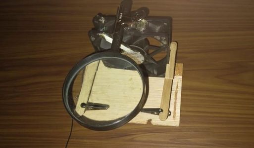

Get a ice cream stick and mark a place to cut. Ten cut off that part and place on the fan. Do it for the both side of the fan. If the ice cream stick is not thick for to glue Place a another stick and place it on the previous stick(make a thicker hand)
I used paper knife for cut them.
Please check Images You can get a better idea than reading this.
Step 3: Make Hand P2

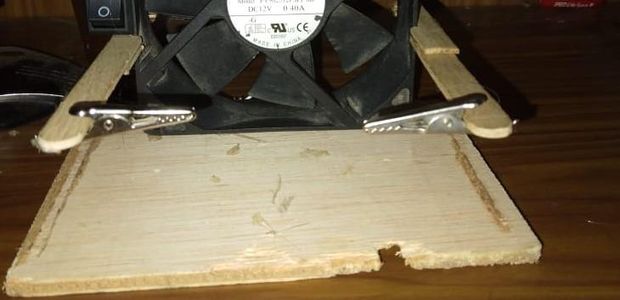

Now get crocodile clips and glue them to other end of the stick.
Glue it any angle as you want to fix it.
Step 4: Add a Floor
Now get your piece of wood and glue it to your fan as a stand.

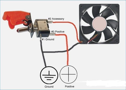

Step 5: Add a Switch to Your Cooling Fan
Add a switch to your fan. So you can turn on when you want it.
Please see the diagram and it explains how switch connect.

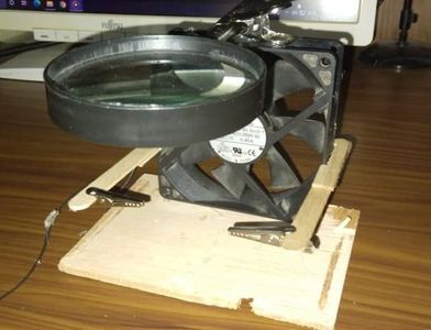

Step 6: Add Magnifier Glass
Now Let's add Magnifier glass to our project.
Get your File clip and place it on your cooling fan. Make sure to center it. Then glue it.!
Now you can place and remove it when ever you want. and you can Adjust your glass as you want.
