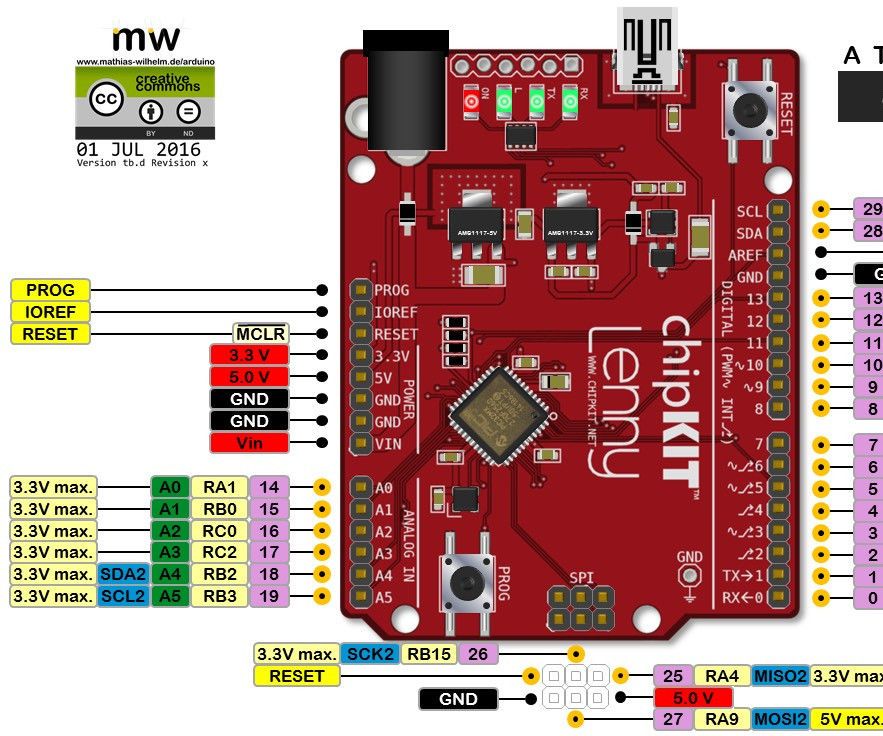

Step 7: Adding an Arduino or ChipKIT Board
I have added holes to the robot that allow me to add a micro-controller board that is Arduino shaped like the chipKIT Lenny or the original Arduino Uno.
With a second micro-controler board on top, the robot can take care of the movements and be configured as a serial slave or I2C slave to take commands from the top board. The top board can be used to execute additional code.
The chipKIT Lenny has the same processor as the robot.
I also added holes to add my HelvePic32SMD board, a board similar to the chipKIT Lenny with a different form factor.
The UART and I2C pins are 5 Volt tolerant. Connecting an Arduino Uno via these pins can be done without level shifting parts.
