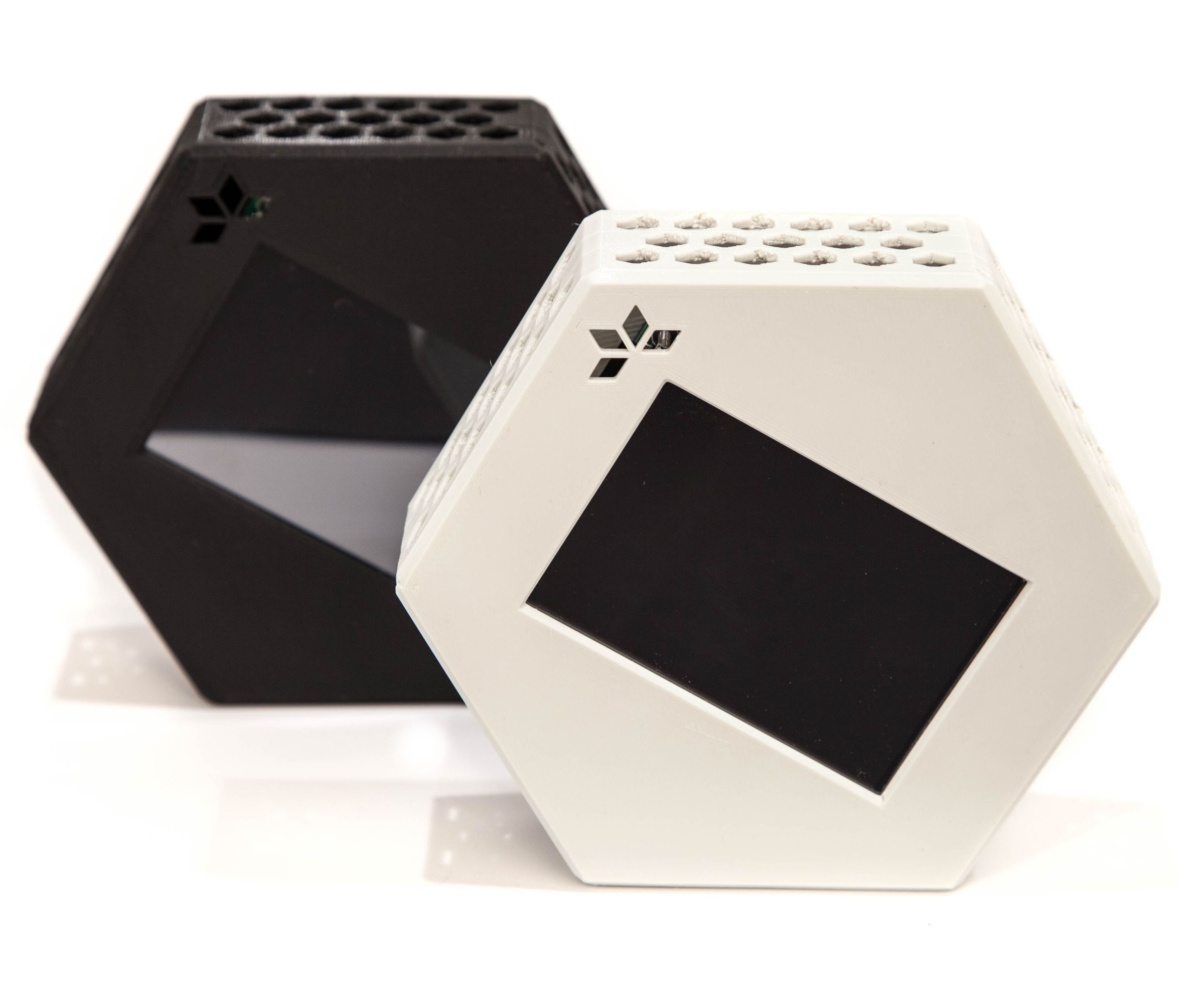

    5. A pretty enclosure should be purchased to stay pretty - so this will be the non open source part of this ible, sorry (I'm working on a 3D printed case)
