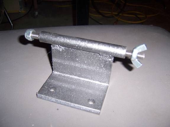

I made myself a small rig for this project so i could easily hold and rotate the coin, but this is not a must.
