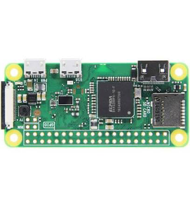

  • 1 * RaspberryPi Mini Computer (available at: https://www.pishop.ca/product/raspberry-pi-zero/)
  • 1 * HiFi Berry Pi Micro Kit (built or unsoldered) (available at: https://www.pishop.ca/product/hifiberry-dac-zero/)
Step 1: Raspberry Pi Build
Build the Raspberry Pi and HiFi Berry devices and connect them together by plugging them in or soldering them together. Download the compiled HiFi Pi firmware from their website. Flash the downloaded image to a MicroSD card large enough for the image. Download and use a tool such as Etcher to write the image to the MicroSD card. Insert the SD Card into the Raspberry Pi. Test the RCA outputs of the HiFi Berry by connecting one to the speaker and setting the speaker volume to -30db. Start using the iPhone power adapter and connect the USB cable to a MicroUSB receptacle on the Raspberry Pi.
