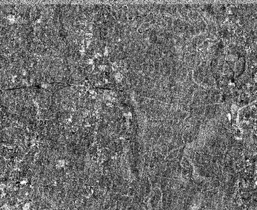

Step 2: Select a Proper Grayscale PNG Image
Yeah, start with a grayscale. Once you understand that, you can proceed with RGB. You can select BMP format also but it is advisable to avoid JPEG if you are not using Matlab since it is compressed using compressing techniques.
You can select a RGB image and convert it to grayscale using photoshop (open image > select Image > select Mode > select grayscale). Sometimes an image seeming to be grayscale is actually RGB. So do check beforehand.
It's better to select a noisy image since after encrypting, the encrypted part will seem totally noisy. So an image which is already noisy will serve as a better camouflage. I chose this noisy satellite image of an area.
Keep it in mind that this original image will be your password to decrypting the coded image. Keep it safe.

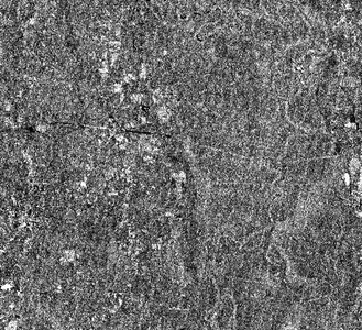

Step 4: Encrypt the Data Onto the Image
You can use various methods of encryption between the data and image pixels. Here a most basic algorithm is followed. You can easily check and modify the matlab codes attached.
Put all the files (matlab file encrypto.m, text file and original image file) in the same folder and run the encrypto.m script. If matlab asks to change default folder then do so.
When the script is run, an image will be created. If you look closely on the image above you'll see the pixels at the top in which the text is hidden (but one can't decipher it without the original image).

Step 6: Now It's Time to Decrypt!
There is no meaning of any lock if there isn't any key. Luckily we have. Here the original image is the key and is used with the decrypting code( attached decrypto.m ). Use the reverse algorithm that you used in the encrypter. You'll get a decrypted.txt file.
