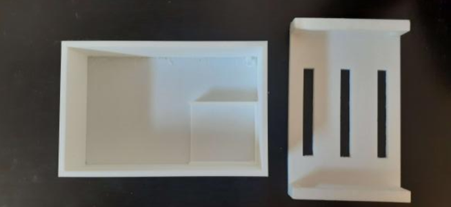

We designed the enclosure to fit the Arduino UNO board, the breadboard, and all the wires. There is an internal structure to prevent the Arduino from sliding around. The enclosure lid has slots for the wiring to run from the inside to the keypad.
We've combined the keys, keypad, and enclosure into one file to make 3D printing much easier. All the parts fit within a 200mm x 200mm footprint so that you can easily print them on most hobby 3D printers.
3D Printing File
Step 3: 3D Printing
Once you have the file from the previous step, you need to import it into a slicing software to 3D print the parts. Using UltiMakerCura, we created this demonstration video. We've used a 25% infill density for a mix of good strength and fast printing time. If you don't have a 3D printer, we recommend checking with your local library or makerspace.
