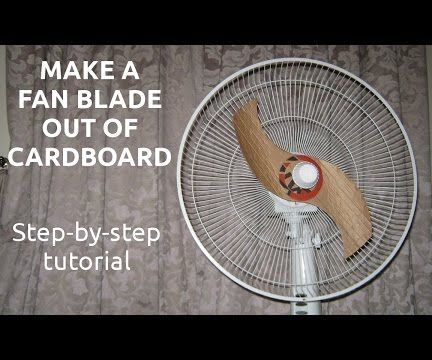

Want to make your fan blow more wind? Or perhaps the fan blade has broken at the time you need it most! Never worry - it's easy to craft your own replacement blades out of cardboard.
In this tutorial I will show you how to craft my hub-and-blade design, building upon previous experience with cardboard fan blade design. After you're done, your fan will blow stronger wind than before!
