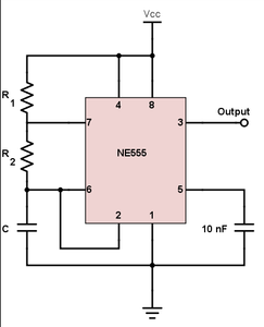

I made this tiny contraption a while back this simple oscillator oscillates a frequency band form about 10k hertz to around 30k hertz.
lm555 ic
15 microfarad capacitor .01 micro farad capacitor capacitor
10k variable resistor
speaker

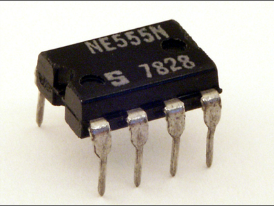

Step 2: The Ic
This lm555 ic is a timer ic with a flip-flop we are going to use it to create an astable multi-vibrator that repeatedly triggers itself to create a clocking output we are going to use that to create an oscillating high frequency noise.
