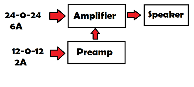

Here you can see I have some stereo and mono amplifier boards, but some of them don’t have good filtration capacitors and proper rectifying unit. And in some of my projects I need dual channel power. 24-0-24 or 12-0-12, with a 3 wired transformer. I want to make a power supply filtration and rectifying unknit that is not only give dual channel but also on different voltages of 12v and 24v.

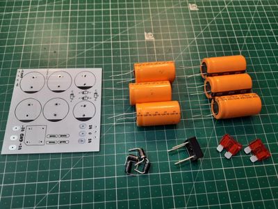

Step 3: Components Required:
1) BR1010 10-ampere rectifier
2) 10A fuses
3) 24,12v toroidal transformer
4) IN5408 diodes
5) 4700uf/50V keltron Capacitors
6) Custom PCB (JLCPCB)

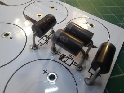

First, I mounted all the diode. I tried to keep them in air so that they can dissipate heat faster.

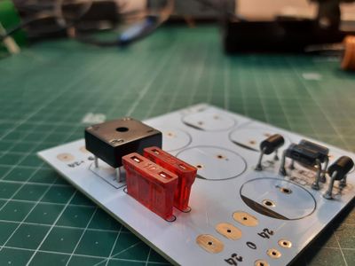

Then I go for main rectifier br1010 (10amps) and fuses.
Step 9: ASSEMBLY:
After this I placed all the capacitors and soldered them properly and here are the beautiful looks of this circuit. The overall finishing work done by JLCPCB is really very decent in that price and white color is what making it more cooler.

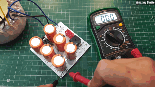

Step 10: Working: With 12v:
Step 11: With 24volts:

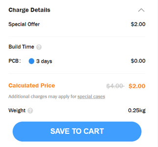

Step 12: PCB Ordering Process From JLCPCB:
The PCB ordering process is very easy, First sign-up to JLCPCB and upload your Gerber files. Then choose material, color, quantity, thickness and surface finishing. Add your PCB prototype in cart and checkout, you will get the package in just 7 days. Wants to know more about SMT service then check this post.
