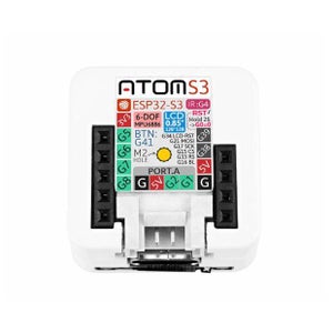

Step 1: M5 STACK ATOM S3
At the heart of HitPad is the M5Stack AtomS3, a compact yet powerful development board built around the ESP32-S3 microcontroller. The ESP32-S3 features a dual-core Xtensa LX7 processor running at up to 240 MHz, with built-in support for Wi-Fi and Bluetooth 5.0, making it ideal for fast, responsive embedded applications.
Despite its tiny 24 × 24 mm footprint, the AtomS3 offers a rich set of features that make it perfect for compact DIY builds. It includes multiple GPIO pins, a programmable RGB LED, a USB-C port for power and programming, and a Grove connector for easy expansion. The board also supports low-power operation, which is useful for portable or battery-powered devices.
As for sourcing the M5STACKATOM S3 we use in our project, we got it from PCBWAY's Giftshop.
