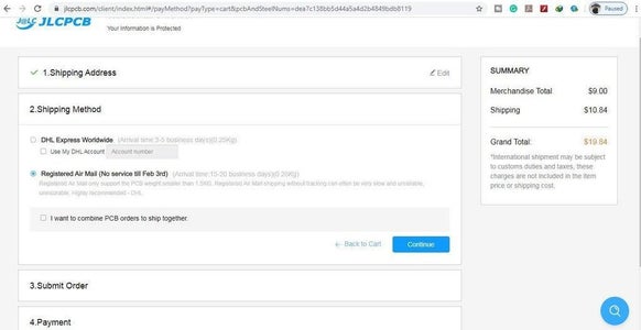

Step 7: Select Shipping Address and Payment Mode
6. Type the Shipping Address.
7. Select the Shipping Method suitable for you.
8. Submit the order and proceed with the payment. You can also track your order from JLCPCB.com.

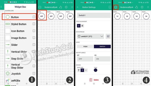

Step 13: Configure Blynk IoT Mobile Dashboard
  1. Select the template that you have already made.
  2. Go to the Widget box (on the right) to add widgets. Add 8 Button widgets from Widget Box.
  3. Go to Button widget settings.
  4. Enter the name, select Datastream, Mode will be Switch. Then exit.
  5. After configuring all the Buttons tap on exit.
