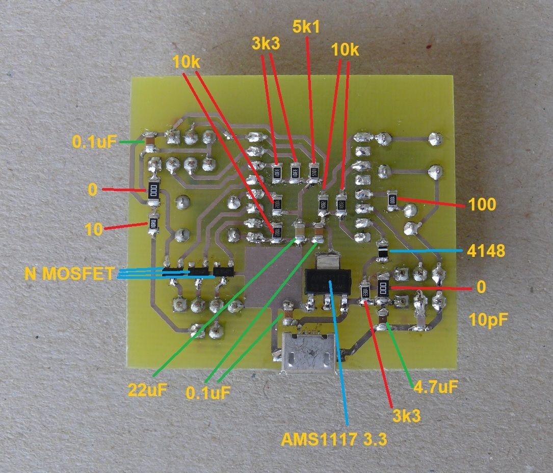

Step 1: Circuit Board
I have attached the PCB artwork. The same result could be achieved via breadboard or stripboard, but the PCB makes a much neater solution.
I have not included an overall circuit diagram as the PCB is single sided and hence easy to reverse engineer for breadboard/stripboard from the PCB picture and artwork.
Components required:
PCB (from attached artwork)
AMS1117 3.3 (20off for £0.99 on ebay)
3 off SOT-23 N channel MOSFET - see comment below
0805 4148 diode
5mm LED green (or red)
0805 ceramic capacitors >6v working voltage):
3 off 0.1uf
1 off 22uF
1 off 4.7uF
1206 resistors
2 off 0ohm
0805 resistors:
1 off 10ohm
1 off 100ohm
3 off 3k3ohm
1 off 5k1ohm
4 off 10kohm
0.1” Pin header 19 ways
2mm pinheader 16 ways
2 off 6mm tactile switch
ESP-12E or F (latter has better range)

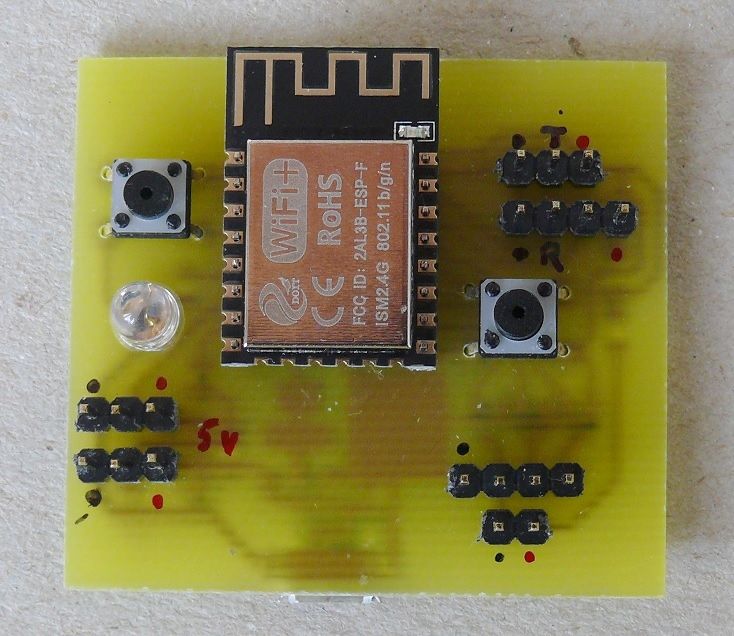

I used an obsolete (but high current) MOSFET in the prototype when I realised that the popular 2N7002 was not going to drive more than around 30LEDs. My next boards will use the PMV40UN2 , Farnell code: 2242071. These have an on resistance of 50mohms with only 2.5v on the gate. There will be plenty more options. Check for working voltage over 15V and on resistance below 250mohms with 3v gate voltage.
My approach to PCB making is to print the artwork twice onto tracing paper. I then overlay these to double the contrast and cover any small imperfections in the printing (I use a laser printer). I punch holes in the edge of the upper layer, place Sellotape across the holes, align and then press on the holes to stick. I have a UV exposure unit. I used to use a UV black light that worked fine with spray coated PCBs and should work fine with positive photoresist boards. I use weak sodium hydroxide solution (drain cleaner) to develop and Di-Sodium Peroxodisulphate Hexahydrate to etch. Take special precautions with the chemicals, especially the sodium hydroxide that attacks flesh instantly. I then expose again and develop to get rid of the film over the tracks and finish off with some immerse tin (quite expensive – and limited life). The latter step is optional.
I drilled the holes for the for the LED and the 2mm pin strip for the ESP-12F at 0.7mm and the rest at 0.9mm.
For component placement see photo below. I use solder paste. Hence the approach - place component, place small blob of paste, solder. Move through all the components. Then apply paste to all the unsoldered pins and then solder these. I leave through-hole parts until after the SMD parts have been be completed.
Note that the LED cathode (flat on base) goes towards the USB connector edge.
Lastly add some guide marks on the board to show +, -, 5v TX and RX:

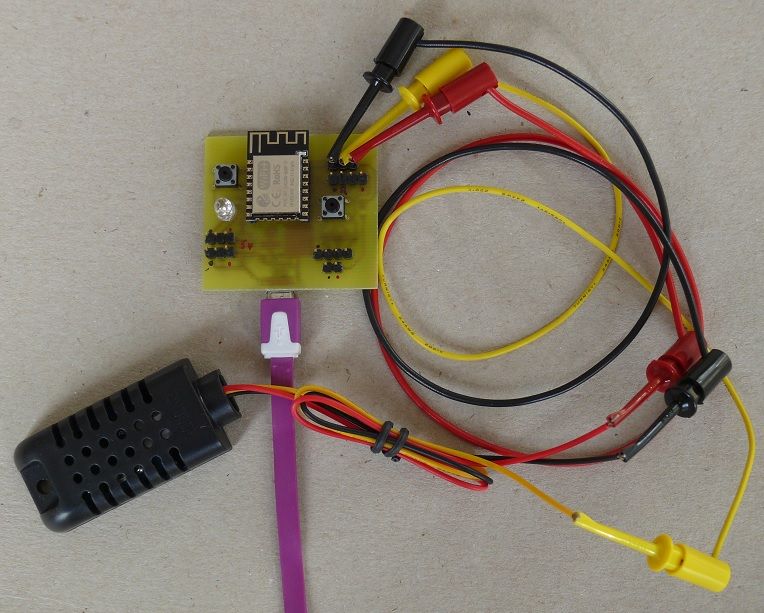

Step 4: Temperature and Humidity
I started with the AM2301 because it was under £2 on ebay. It is fine to show the principles and the code required, but I was not impressed with the accuracy – reading high by more than 2°C.
First send the topic cmnd/sensor/gpios to get a list of the gpio options. The AM2301 is “2”. We want to connect this to gpio 1 so send topic cmnd/sensor/gpio1 with payload 2 . You should see a response in the debug output that includes "GPIO1":"2 (AM2301)" and the device will restart.
Connect 3.3v, data and ground of the AM2301 to the 3 way header, double checking polarity:
Power up (USB supply). The data is sent every 5 minutes. It can also be obtained on demand via a request for sensor data. This is done with Status 10. So send Topic: cmnd/sensor/Status , Payload: 10 . You will see in both cases the data appears in a somewhat complex/nested JSON string. The 5 minute data comes with topic tele/sensor/SENSOR. So this is what we need to subscribe to. The first level of the JSON string has names Time, Switch1, AM2301 and TempUnit. Within the AM2302 data we have another JSON string with names Temperature and Humidity. This needs to be converted from a JSON string to a JSON object before we can extract the data. Fortunately there is a node to do this.

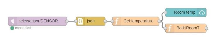

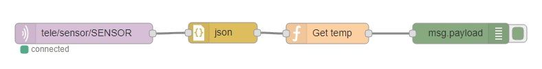

Set up an mqtt input node with Topic: tele/sensor/SENSOR and connect this to a JSON function and from there into a function node and thence to a debug node. The function node can then extract temperature using the code:
var temp=msg.payload.AM2301.Temperature;
var msg = {
payload:temp
return msg;
The setup can be imported by copying the contents of NRAM2301.txt attached . Click the Node-Red options button (top right) and select Import>Clipboard. Then paste the code and place it into your flow.
A similar approach can extract Humidity.
At this stage the data is just being sent to the debug. It can also be sent to a web interface using a dashboard text, gauge or chart. It can also be made available globally for decision making as will be shown later in the electric blanket example.

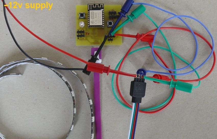

Step 6: RGB LED Strings and Relays
The RGB LED string is driven via three pwm outputs, one for each colour. These also need 12V.
First set up the pwm outputs. For Red set up pwm1 on gpio4. pwm is '33' from the gpios enquiry sent earlier. So send topic cmnd/sensor/gpio4 with payload 33. The response will include "GPIO4":"33 (PWM1)". Now do the same for green and blue with topic cmnd/sensor/gpio2 with payload 34 and then topic cmnd/sensor/gpio15 with payload 35.
Next check the LED string to find with pin is which colour by connecting to a 12v supply. On mine the common +12v was white, the green wire was blue, red wire red and blue wire green.
Now connect as below:
The system can either drive a WS2812 neopixel string or an RGB string but not both at the same time. To switch to the RGB string and pwm outputs use topic cmnd/sensor/SetOption15 and payload 1 . If a WS2812 string was connected it will hold the last colour set. When switching back the RGB outputs are set to Green. With SetOption15 set to 1 or ON the RGB string can be controlled by the colour picker as setup for the NeoPixel string in the previous section. If you want to drive the PWM outputs you need to remove (or not install) the WS2812 NeoPixel gpio (remove via cmnd/sensor/gpio13 and payload 0).

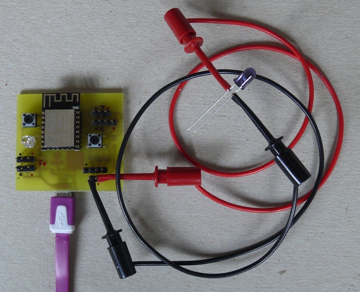

Step 7: IR Remote
The IR remote capability has been programmed for major players e.g. Sony, Samsung. Check the Sonoff-Tasmoto Wiki for details (IR at bottom of page).
Connect an IR diode to the 2 pin connector. The negative pin is next to the flat on the diode base. I used an LD271. Hopefully you will have a diode from that old IR remote you didn't throw away!
We need to set gpio15 for the IR. So send topic cmnd/sensor/gpio15 with payload 8.
Follow the link on the wiki for the IR remote database. My test was on an LG television. This uses the NEC protocol and 32 bits. I could not find the exact model but one that was pretty close. Power was 0x10EF and the pre-data 0x20DF so all together 0x20DF10EF or 551489775 decimal. So the data/payload to send to topic cmnd/sensor/IRsend is {"Protocol": "NEC","Bits": 32,"Data": 551489775} . The response should be: {"IRSend":"Done"} . This turned my TV on and off. The range was around 3m with the IR diode pointed in the right direction. There is scope for increasing the power by reducing the 10ohm resistor. It I were to do this I would also add a capacitor, say 22uf across the power rails at the location below.

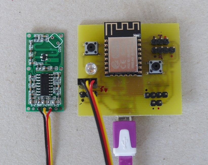

Step 8: Microwave/Radar People Detection
I was intrigued by the incredibly cheap radar/microwave detection modules. So I thought I would set one up to tell me someone is at the door. With the sensor inside it will respond to someone around 4m away - through a grp (I think) side panel to the door.
The sensor has 5 connections but we only need VIN, OUT and GND. These need to be connected to 5v, input and ground. I used an old servo lead to make a connector, swapping the yellow and red so the input would be the middle pin. This connects to the board as below:
The input goes to gpio12 and the action is switch1 in follow mode (1).
So send topic cmnd/sensor/gpio12 with payload 9 and then topic cmnd/sensor/SwitchMode1 with payload 1 .
The system is set up on the assumption that the switch will change the output relay. To use it as an input to drive another device we need to change the topic. In this case Node-Red needs to pick it up. So use cmnd/sensor/SwitchTopic with senSW as payload. We can subscribe to this and trigger a voice alert.

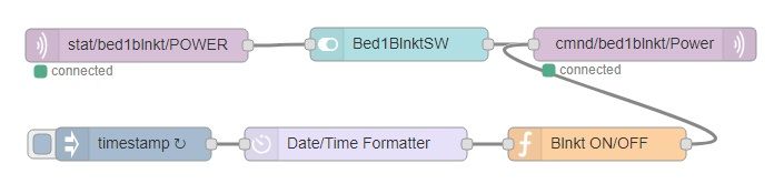

Step 10: Automate an Electric Blanket
The main point of this case is to show an example of a timed event that includes decision making using several inputs.
Home automation is about comfort so I thought I would set this up. The rule I wanted to code is:
"If the bedroom temperature is below a user set temperature, 30 mins before bed time, then turn the electric blanket on. Then turn off at bedtime."
A problem that has to be addressed is how to handle a decision (function) where the inputs come in at different times. The solution used here is to save data in global variables that are persistent and can be accessed by any function. An alternative, where the data is in JSON strings and hence can be identified, is to use 'context' to save data within a node and then take action when all the data is assembled.
In this case we have inputs of time, bedtime, actual temperature and set temperature. We need a function to output ON or OFF to drive the blanket switch plus something to trigger the function at a suitable frequency.
While setting this up I had browsers open both to the Node-Red page (IP address:1880) and the Node-Red dashboard page (IP address:1880/ui)to check progress. I had also programmed a sonoff switch and set the topic to bed1blnkt . See Powerful Standalone Home Automation System - Pi, Sonoff, ESP8266 and Node-Red for how to do this.
Before setting up the flows we need a time function to deliver real time as the timestamp is only UTC and ignores summer time/daylight savings. After some search I decided that the one to use is one called 'moment'. In Node-Red go to the settings (top right) and select 'Manage palette'. Then click the Install tab and enter 'time' in the search bar. I was tempted by 'BigTimer' that has many features such as calculating dusk and dawn times based on location but thought I would keep it simple at this stage. Click more to get to 'moment' and click install.
The order the pieces of the jigsaw go together is not important. I had a rough sketch of what I wanted the dashboard display to look like and so started at the top and worked down. However moving items around on a dashboard page is pretty easy so any other approach would be just as good.
So lets start with showing the current time updated every second. Add an inject node with timestamp and feed this to a moment note and from this to a dashboard text. The timestamp needs to be set to have its repeat interval set to 1 second. On the moment node set input time zone to ETC/GMT and output tz to Europe/London and Output Format to HH:mm:ss . These will be different for non-uk locations. In the text node set the Group to a new group (click the pencil) called Blanket and new Tab called Bedroom1 . Then set size to 2x1, Label: Time, and layout with Label above value. Click deploy and check Node-RED Dashboard that the time is there and ticking away.
Next add a slider and text display to give bed time in steps of 5 minutes from 10pm to 12pm - so 24 steps. Add a slider for the 24 steps, feeding a function to convert these to Bedtime and a text display to show the Bedtime. For the latter is is easiest to copy and paste the Time node so all we have to do is change the name to Bedtime. Check slider is set to Group Blanket[Bedroom1]. Set the Label to Bedtime and Range 0 to 24, Step 1. Name the function No. to Time and enter the code:

I also wanted a manual switch as an additional way to turn the blanket on/off. So add a mqtt input note and feed this to a dashboard switch and from this to mqtt output note.
Set the mqtt input topic to stat/bed1blnkt/POWER and set QOS to 1. Set the output topic to cmnd/bed1blnkt/POWER and QOS 1. For the switch set size 2x1, untick 'if msg arrives on input, pass through to output' and select 'Switch icon shows state of the input' , and set on payload to ON and off to OFF , and set name to Bed1BlnktSW . Note this setup makes sure the switch icon shows the switch position regardless of from where it is changed.
Next we can add the bones of the setup to implement the action. I decided on running the function every 10 seconds. So setup an inject node, feed this to a moment node and from this to a function and from there to the mqtt output node driving the switch. Set the inject node to send a timestamp at an interval of 10 seconds. Set the moment node with Input Timeszone UTC, Output Format: object, and Output Tz to Europe/London. Set the function name to Blnkt ON/OFF. We will set the code for this when we have the temperature data.
Most of the room temperature setup is as shown earlier for the temperature humidity example. However instead of sending the output to a debug node sent it both to a dashboard gauge and to a function. I named the gauge Room temp , set the group to Blanket[Bedroom1], size 2x2, type donut, label Room, value format {{value}}°C , range 0-20, colour gradient blue to green to red. Name the function Bed1RoomT and enter the code:
var v= msg.payload;
global.set("Bed1RoomT",v);
return null;
This saves the temperature to the global variable Bed1RoomT .
Now we just need the slider to set the trigger temperature. Add a dashboard slider and set label to Set temp , set the rage to 0 to 20 and check the Group is Blanket[Bedroom1]. This needs to feed a gauge and a function similar to Room temp. So select these, copy and paste. Then connect to the slider output, change the gauge label to Set and the name to Set temp gauge . For the function change the name to Bed1blnktSetT and set the second line of its code to:
global.set("Bed1BlnktSetT",v);
We have the room and set temperatures as global variables. We also need the number that set the bedtime. So in the function 'No. to Time' above add just under the first line:
global.set("n2bed",v);
Now we are ready to set the code for the decision function 'Blnkt ON/OFF'. First we need to change the number from the set temp slider to the number of minutes after 10pm. Then we can do the same with the time input from moment. In order to limit the number of times the function operates when the minutes match I added the conditional that seconds were less than 30. So the code required is:
var object = msg.payload;
var v = (object.hours-22)*60 + object.minutes;
var msg = {
payload:"OFF"
if(v==global.get("n2bed")*5 && object.seconds <30) return msg;
var msg = {
payload:"ON"
if(v==(global.get("n2bed")*5-30) && global.get("Bed1RoomT")< global.get("Bed1BlnktSetT") && object.seconds <30) return msg;
return null;
One last detail is to connect the output of the 'Blnkt ON/OFF' function to the input of the mqtt output cmnd/bed1blnkt/Power .
Also go to the dashboard tab and then to layout and change the order so to get the dashboard above.
